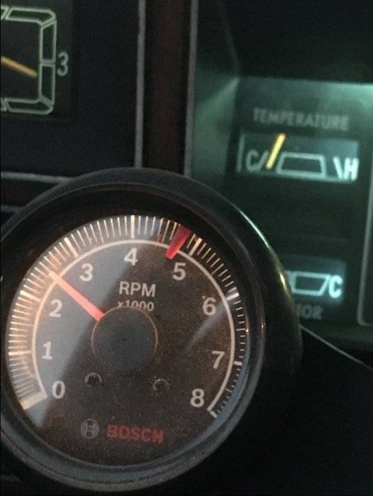

Okay, new thread. I don't suppose anyone can explain to me why....occasionally on cold mornings (which really isn't that cold, because I live in the OC Socal, its like constant 72 degrees almost year round) why my car idles at this high of rpm during warm up? In the picture, basically almost too normal op temp and revving so high, even after pumping throttle a few times to try and kick it down. It usually does kick, sometimes right after I start the thing. Occasionally, it will only kick down after I rev above 4,000 rpm Lol, thing has a mind of its own. The carb is brand new from Rockauto. Carter BBD with Idle enrichment and the EGR dump, what the car originally came with. I've tuned the thing with a vacuum gauge and rpm settings are set to factory spec. Choke coil is a brand new G.P. Sorenson. Have a NOS Mopar on standby.

When somebody says a carbed car is cold, it is not only due to outside temperature. The engine is "cold" (as in below normal operating temperature of the engine) even when it feels warm outside to humans. The determinant of how "cold" an engine is the temperature of the exhaust gas going by the bimetallic strip that controls the choke lever on the carb. Only when the exhaust temperature has gone over the temperature at which the bimetallic strip begins to move to the point where the choke lever on the carb will the choke "kick off". That temperature may be reached quickly, if the car was in use just moments ago, it may take a longer time, if the outside air is cold and the car has been sitting around in those cold air temperatures.
Of course, this all depends on the choke working properly. If you don't have cold start issues, or driveability issues, and the choke does kick off, it should be fine.

When the car warms up, it runs perfectly. Almost like a hot rod. Nonetheless, until it reaches 195 degrees, I experience all kinds of issues. If I fire it up and try to drive it right away, it won't go over 2,000 rpm, as if it has a governor. In neutral it will rev to 6,000 cold. It tends to stall unless I feather the pedal when driving during this time. Its not a typical thing, I always try to let it warm up at least 5 min. Even so, I just can't understand why the car would ever need to warm up at 2,500 rpm, that just seems way too high. Supposably the idle enrichment is supposed to aid the driveability during warm up. I don't see it happening though.

One thing to keep in mind also is, cars of the era (especially CA emission) tended to stall on cold starts, cut out on acceleration until warmed up, etc............. If everything is stock and adjusted to stock specs is what I mean.
That said, 2,500 rpm is way too high for the fast idle. It should be around 1,600 rpm. Like Bud mentioned, you'll need to adjust the fast idle stop screw.
Not sure if your choke t-stat is electrically heated but if it is, make sure the heater is being supplied with battery voltage with the key on or engine running.

It has a duralast choke coil on it now with the warm up wire. The wire connection was always loose and prone to falling off. I crimped it harder with a pair of plyers and it seems to work fine. I just don't trust that duralast for some reason though. So, I purchased a Ma Mopar choke thermostat, which I been meaning to install. I get a feeling though that its something with the carb, even though its brand new from RockAuto.
I have gone through the proper procedure, as it is, both idle screws are where they are supposed to be. The entire speel has been performed at least three times. I do set the fast idle @ 1500 rpm while the engine is at normal operating temp. My Haynes Instruction manual says to place the the fast idle cam on the second notch and adjust to spec. Now, some mornings it idles @ 2500 and others @ 1400. It can't decide.
In the past, I've actually tuned it down to 1500 while it was fast idling at 2500 during warm up. This didn't work out very well. Afterward, some mornings it would idle at @ 500 rpm and others @ 1500.
I wonder if I have a vacuum leak somewhere still. Perhaps a bad power heat valve vacuum diaphram or vaccum line? Or maybe one of the vacuum switches on the manifold. Something in the warm up circuit, but which is shut off once the engine reaches operating temperature. When I used the vacuum gauge during warm up, it was right on the cusp of being too low about 17 in. After the engine warmed up the vacuum was right about 19-20 in. During this time the engine runs fine. But before operating temp it suffers a severe loss of power, cruising down the road car won't rev above 2,000 rpm, like something is holding it back. After it warms up though, I can push it to 3,000 and it runs and drives normal.
