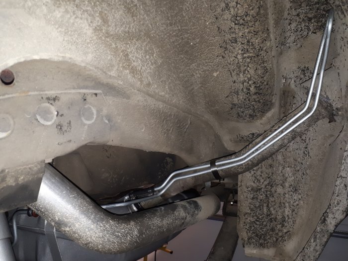

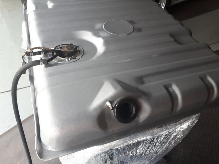

After you junk the canister and rubber lines you can either put a sock filter on the steel vent line, or pull it out entirely and run a new vent line from the top of the tank to somewhere higher than the topmost point of the tank. If you're going option two you can run it to the top of the fill neck and use a rollover valve. I did option two, but I don't have a factory tank anymore.

Here's how I did mine.
