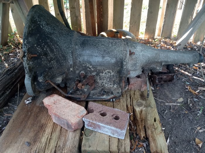

Thank you in advance for any information. I don't know what vehicle it came out of. I believe it is a 904? I'm looking for assistance with identifying and possibly a value or toss in scrap pile. Any help is greatly appreciated. Thank you

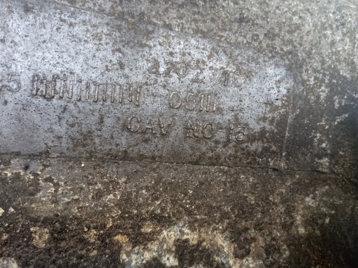

Don`t see that number. The closest I see is 4348703 which is a 86 318 904 diplomat

Looks like a 904. If the pan is a square with that visible corner cut off its a 904. If it has a bulge on the other side it's a 727.
Might be worth something to someone who wants the 998/999 gearing but not worth much.

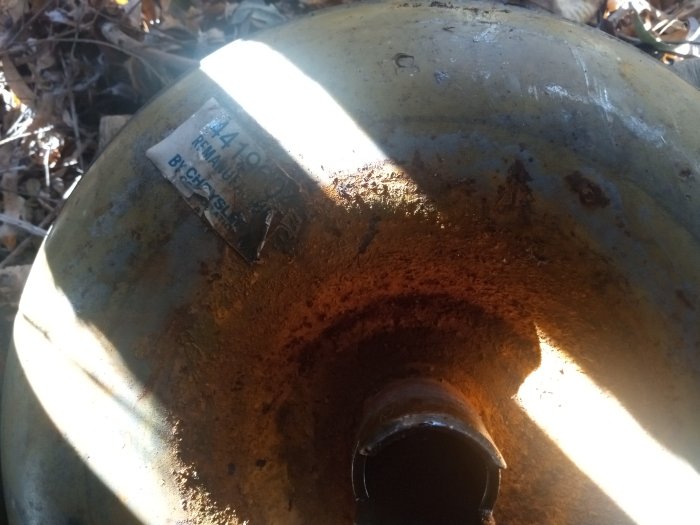

Core price Upstate for a 904 is $50 to $75. That torque converter is a core/junk though

Ok. Good to know. Well I guess I melt her down and scrap the converters. One more question please. Can I believe the housing is all aluminum in 1986 like the transmission was in 1960? Thank you guys for crashing my dreams of riches.....lol. Thank you for your wisdom.

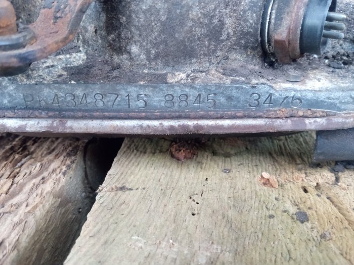

4348715 4058398 318 A999 Part Throttle Unlock. 86 Dodge Truck
That's a good one, don't scrap it till others have chance to get it.

For someone that wants to build up a 904 this could have some good parts: I'm thinking the 2.74 1st gear set, which I thought only came in the later 904s, no?

Yes and potentially some other HD items. worth stripping at least if still around.
