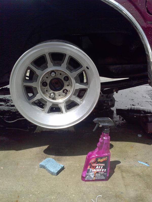

I am trying to get the alloy wheels on the 1980 Cordoba cleaned up. I have been able to get most of the crud off, but now there are these little brown specks all over the wheels. I was under the impression that the specks may have been baked on brake dust, but brake cleaner doesn't have any effect on the specs. I did try using some 0000 steel wool, and it does take it off slowly. Problem is, the brown specks are on grey area and I am concerned that if I use the steel wool on the grey areas, I will take the grey color off, which I would prefer to not do, as I am not sure I can get the correct shade of grey painted back on.
Does anybody know if there is some sort of chemical that can take the brown spots off without damaging the wheel or taking off the factory grey paint. If I have to sand/steel wool off the brown specks, does anybody know where I can get the correct grey color to repaint the wheels?

Sorry for this answer but either you will have to wet sand them and paint them or have them media blasted and powder coated.
Bremeric:
No need to be sorry, if that's the only way to get them looking good, then so be it. I was hoping to avoid it, but if sanding/media blasting is the only way, I can have that done. By media blasting, I am assuming soda blasting, because they are aluminium.

I won't be using sand as the blast media. I will be using crushed glass (not glass beads). According to Eastwood, whose technical support people I had a conversation with, that is the correct media to get factory wheel paint off with. Turns out that the factory paint is a lot tougher than body paint. Body paint can be removed with soda without damaging the underlying metal. According to the Eastwood tech support guy, the soda won't touch the wheel paint. It needs medium to fine grit crushed glass. If you use the coarser crushed glass, it still may damage the aluminum (he called it texturing). The finer crushed glass (medium to fine) will take off the paint, clear coat, and other residues, but won't mark up the aluminum.

Oven cleaner has no effect on the paint. Aircraft stripper has no effect on the paint (after 6 tries). The oven cleaner removes the clear coat, does nothing about the actual paint. Same goes for the aircraft stripper. Eastwood tech support told me that for most factory paint on wheels, crushed glass blasting is the only way to remove the paint on wheels quickly without damaging the aluminum underneath. My attempts with the aircraft stripper seem to indicate he is right.
The aircraft stripper was great removing the paint off of a pair of valve covers. Paint just wrinkles up and comes off really easy. The wheel paint doesn't react in anyway, even when combined with scrubbing with a Scotchbrite pad. No chemical reaction of any type.
