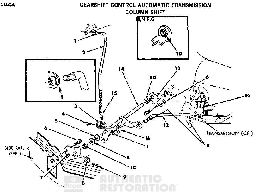

So as a way to try and forget about my oil leak and first fire issues for now, I am gonna ask about something that I am hoping is a no brainer.....so I can feel like I am accomplishing SOMETHING. LOL
There is a metal shaft that runs side to side on the car, under the hood.....between trans and frame...and connects to the linkage from the column shifter. It rotates when you work the column shift. basically a Z bar, for the A/T/
I seem to be missing the clip that secures that cross shaft into the frame side brace.....the shaft has a divot in it as though its a clip of some type. But I have no idea what it should look like...or where to get it.
Any ideas? 1980 Volare two door, A/T, slant 6.
Thanks folks
There should be a washer and a small hairpin type clip. Kind of like a really small hood pin clip.
The pictures are from my '79 parts book - but should be the same.

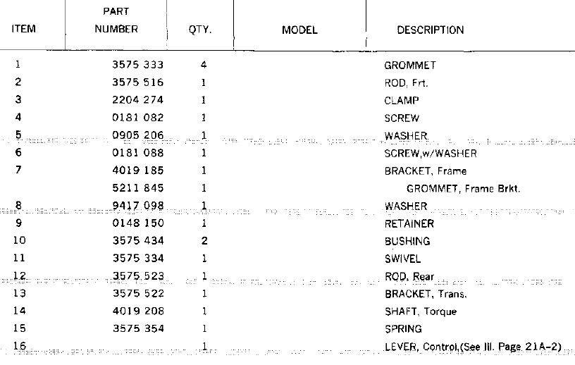

It is part number 9 in picture (not a very good picture) and is a normal hair-pin clip (not sure what the official name is).
The Dodge part number is 148150 and official part nomenclature is “3/8x3/16x11/32”.
I guess the term “clip” or “retainer” is optional (me shrugs).
The retail price (MSRP) is a whopping $0.10 (US)
It might cost more to get one at a hardware store - but I would go to a hardware store to get it and the washer. I doubt the dealer will sell you one for less than $3.00 – just because they can.
This part looks like a “B” with another “R” on its end, if stood on its end.
The washer is just a plain flat washer.
