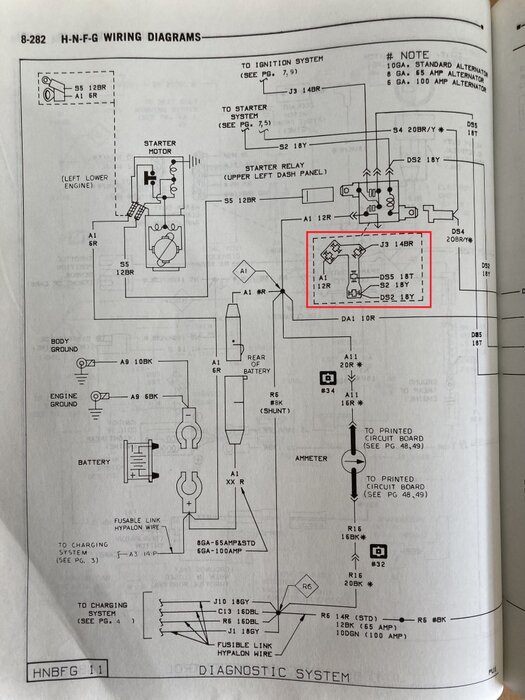

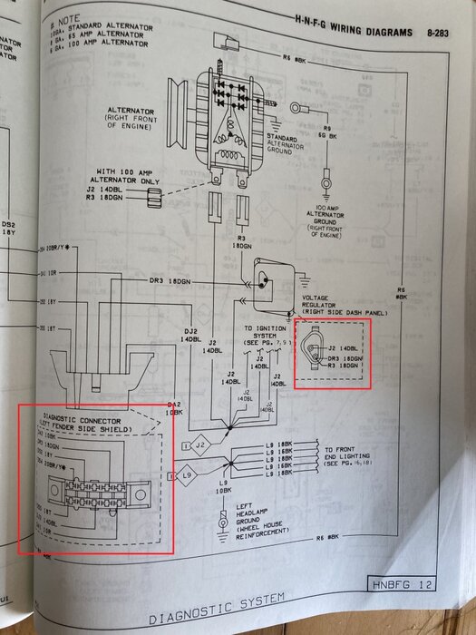

Here are the two pages from the manual with the main problem area identified as examples.
How do I know what the gauge wire should be?
I found the color code legend earlier in the manual, but I missed the explanation for the wiring gauge.

The number at the end is the guage. First pic you squared at starter relay. 14BR is 14 guage brown wire. At the battery 10 black etc.
The following applies:
A1 12R
-> A1 is the circuit code, to easily identify the same circuit on many pages
-> 12R is 12 AWG, Color red
Other example: DS2 18Y
-> Circuit identifier DS2
-> 18Y is 18 AWG, Color yellow
So the first part is to identify on the wiring schematic, the second part is actual AWG plus Color (on some page upfront the color coding is explained)
20 AWG is quite thin. :)
If you're not aware, the higher the number, the smaller the wire. Always seemed backwards to me but, what do I know? :)
It's OK to, for example, use 14 guage to replace 16 guage, but not vice versa.

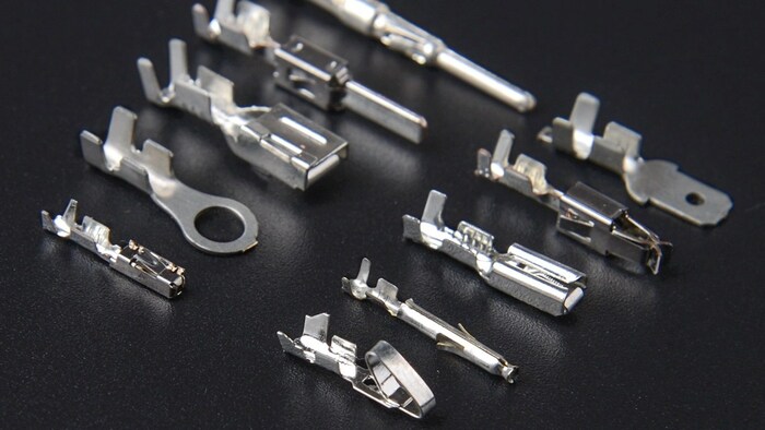

Use this (Certi-Crimp, F-Crimp, or Open Barrel crimp):
Here's some advice (have not read all):
VW Baywindow Bus - Wiring Harness Terminals
How to Crimp Open Barrel Terminals
I have no idea about it's quality:
225pc Delphi Weather Pack Terminal Ratcheting Crimping Tool & Connector Kit 767870179921 | eBay
And I'd also suggest not to use the cheaper crimp things:
Don't use this:
Cables easily slip out of such connectors....
