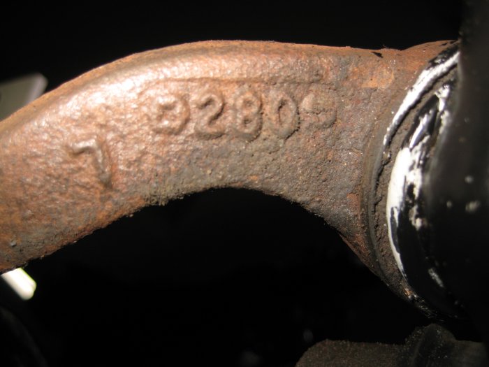

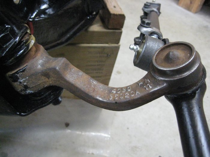

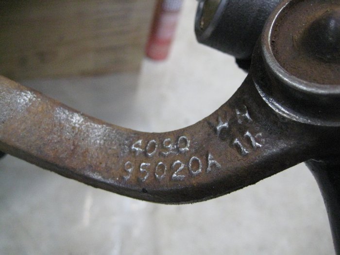

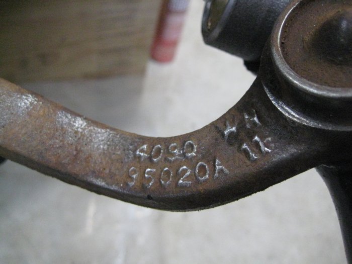

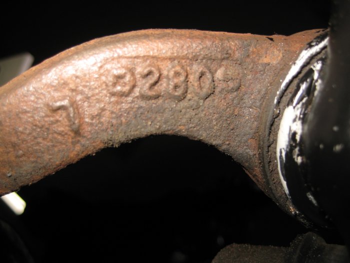

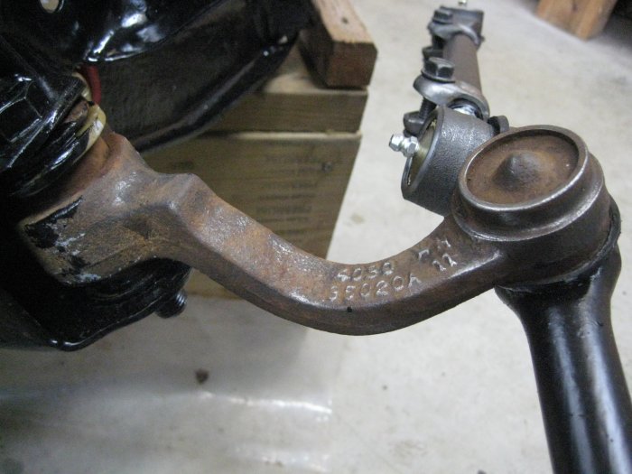

At any rate as soon as it arrives I will take comparison pictures between what is currently on my car and the TRW item and post these to both threads. From pictures the most noticeable difference is the pivot joint at the K frame. All the 'non-police' ones appear to have a grease nipple at the centre link ball joint AND at the K frame pivot joint. My AHB car is low mileage and my assumption is that the idler arm currently on the vehicle is the original factory item. The K frame pivot joint on my car does NOT have a grease fitting at either joint AND the K frame joint appears to use a self-lubricating Nylon sleeve bearing.
Below are 3 pictures of my existing (original?), idler arm. Picture 1 shows black paint swatches on the frame pivot - I'm painting the K frame with POR Chassis Black. Waiting for the TRW part to finish the K frame paint job.
As I said, I'll add pictures to this thread as soon as the TRW bit arrives here (bottom tip of Nova Scotia, a stones throw from the Atlantic Ocean :).
Figures crossed it clears up the mystery. :) Hope it helps somewhat.

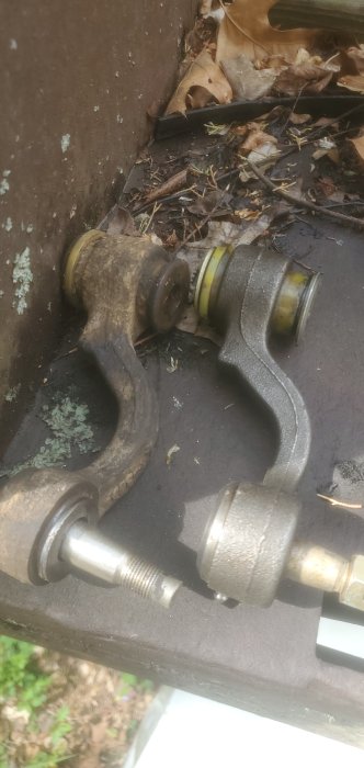

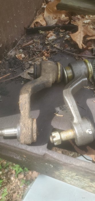

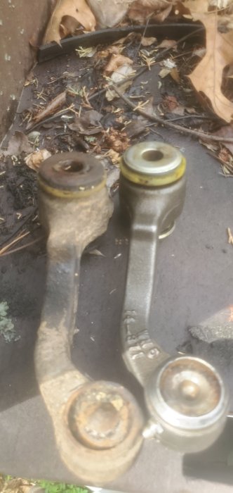

Mine came in today. I'll take some pictures

Like they say, a picture is worth a thousand words! Glad you got it sorted. What part number did you use as the TRW 18795 number is becoming a NLA item? Might help someone in the future.
DumpsterFire
Dec 23, 2024
21
4
North Carolina
TRW 18795 is what I used and I had to buy it second hand new old stock. So not a great answer but there do seem to be a good few out there like that

You sure? It looked like it would've flopped around in there if I used a non cop arm
Mikes5thAve
Mar 3, 2020
1,781
734
Yes. That might be why some of them come with extra washers.
Doing a Google search there doesn't seem to be any reference to the TRW one being a police part. It looks like at one point it was the standard idler arm for A bodies along with the other part numbers being sold.
Oddly enough in the Chrysler parts book they don't show any different part for police, only the steering box itself.
