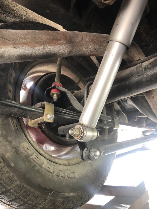

Added an M body cop car rear sway bar to my J body Cordoba. The dimples to locate frame rail mounts were right there. Since im running an 8&3/4 I had to use an e body mount to locate the sway bar endlink. On my two mile trek, I immediately noticed a considerable change in the handling of the car. It was way more stabl.
