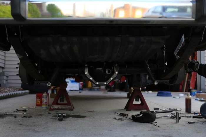

1980 Diplomat S-Type Coupe with factory optioned t-tops and 318/904/7.25 and A/C. When we got it the factory drive train was already long gone and it had a 360/727/8.25 in it.
As it stands now:

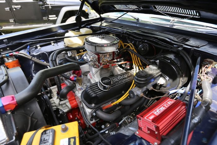

  • Engine
    • 1991 360 LA roller block bored .030"
    • 4" forged crank
    • forged rods
    • forged pistons, 10.5:1
    • Factory mains with ARP studs
    • Comp roller cam XE286
    • Eddie closed chamber aluminum heads with gasket matching
    • Eddie RPM Air-Gap intake
    • Holley 770 Street Avenger carb
    • MSD 6AL II ignition
    • Champion three core aluminum radiator - 26"
    • Dual Ford Contour electric cooling fans, Dakota Digital controller

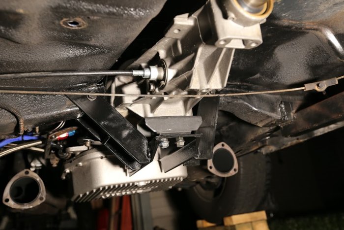

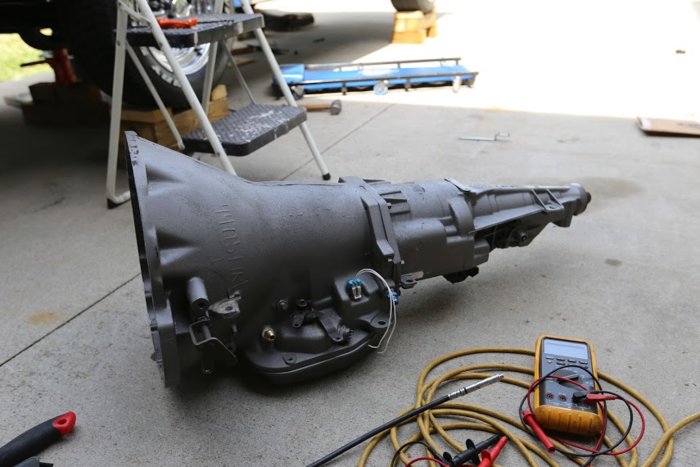

  • Transmission
    • 518 non-lockup 4 speed OD
    • Deep pan
    • 3000ish stall Turbo Action converter
    • Trans Go shift kit
  • Axle
    • 9.25 axle pulled from an early 80's 2wd 150 RAM
    • 3.90 gear
    • Sure Grip
  • Chassis/Suspension
    • Frame ties
    • ISO delete
    • Police package front and rear sway bars
    • Firm Feel 300# torsion bars
    • Firm Feel aluminum K isolators
    • Borgeson steering box
    • 11.75" front brakes
    • 10" rear disc conversion from Doctor Diff
  • Other stuff
    • Cragar S/S wheels (new style without the stupid shouldered lugs)
    • 275/60/15 rear tires
    • 235/60/15 front tires

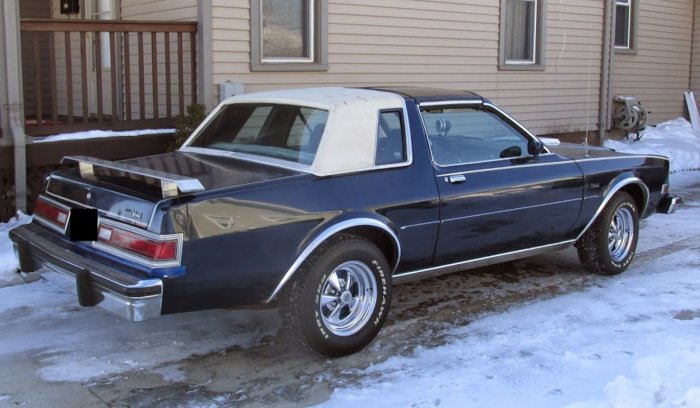

    • Repainted factory midnight blue
    • original vynal pin stripping had painted back on
    • custom built rear spoiler
    • Functional scoop from Summit custom installed
Only other things Dad wants to do is CNC port the heads and install a set of stainless 1 3/4" headers. I'm still trying to get him to fuel inject the car.
A few of the photos are older. The fin and scoop are painted body color.

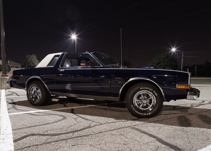

She's beautiful but damn are her bottom bits low. Really puts his faith in those FirmFeel torsion bars huh.
Yeah, we both do. I have yet to bottom anything out and so does Dad. I thought you had a set?
