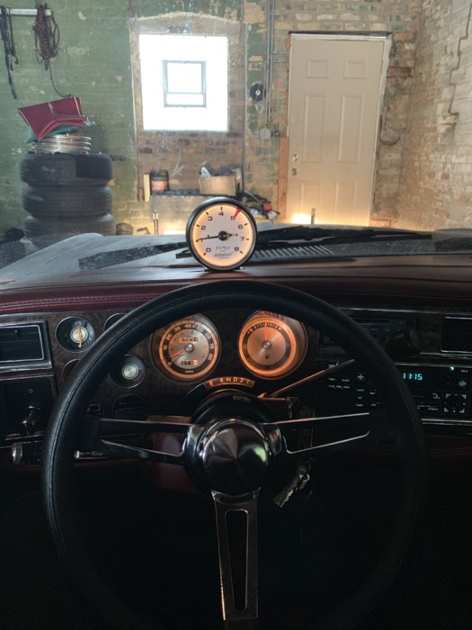

I would love to figure out a factory looking tach for where the huge fuel gauge is then put the fuel gauge in where the idiot lights are on the left, maybe a K-car fuel gauge or something. Someday maybe I'll get to it. That will be the week after I solve famine and peace in the Middle East.
I’ve thought about getting rid of the airbag indicator (air bag is deleted from the car) and replacing it with a small fuel gauge so I can put the tach in the dash we’re the large fuel gauge is but, I think making a whole custom gauge bezel might be the way to go. Not sure...but I really like the fuel gauge that’s the size of Wyoming too lol I’ll figure it one day

The only thing making me postpone doing it to one of my Diplomats is that the cavity where the fuel gauge is is pretty shallow compared to any tach I would put in there, otherwise all you do is pick a tach, get the needle to come through and use dry transfer letters and numbers to turn the silver and black face into the new tach face. I think an old Omni or minivan fuel gauge looked pretty close to put into the small idiot light pod

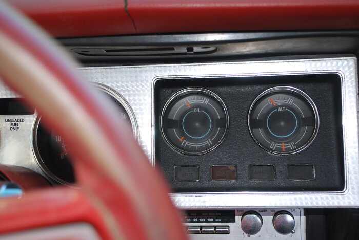

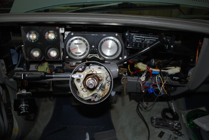

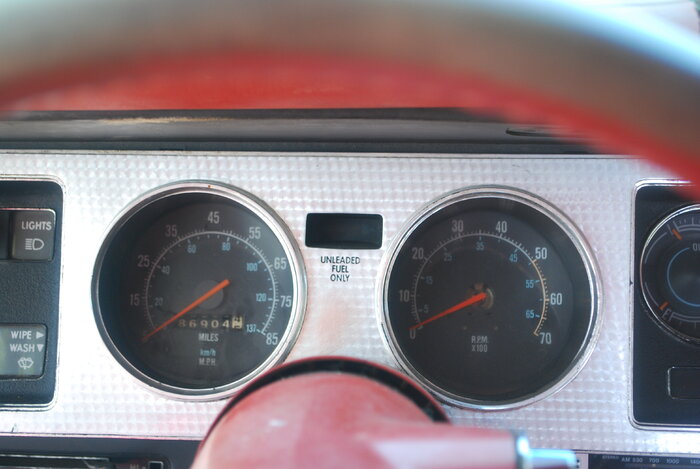

I'm only about 4 years late to the conversation but this topic interests me because it is exactly what I wanted to do on my '79 LeBaron. I often thought, "Why did Chrysler put a huge fuel gauge that's the same size as the speedometer and right next to it? Is this so you can see the gas gauge go down when the speedometer goes up?" LOL! I do however, have a '79 300 that I bought as a parts car and it has the factory tach next to the speedometer. However, the other gauges would take some very creative thinking to install them into my '79 LeBaron. Here are comparison pics.

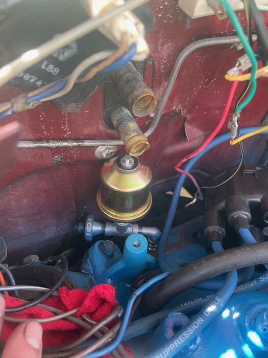

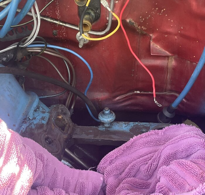

My 78 wasn't built with an oil pressure gauge, so I used the 82-88 fleet gauge. It's 12 volts so wiring is easy and the correct pressure sender is easily available. It's really very tight for space back there but I got it done. I can't be without an oil pressure GAUGE. As you can see, I keep the light too. The "Purchase engine" light isn't cutting it for me. I had to lop most of that one heater core bolt off to get the giant sender to fit. I never replaced the heater core because I would have a 123.83945% chance of cracking a perfect dash. With the distributor in it, everything is packed. I couldn't imagine an HEI distributor back there. I am used to having the sparky thingy in the front.
