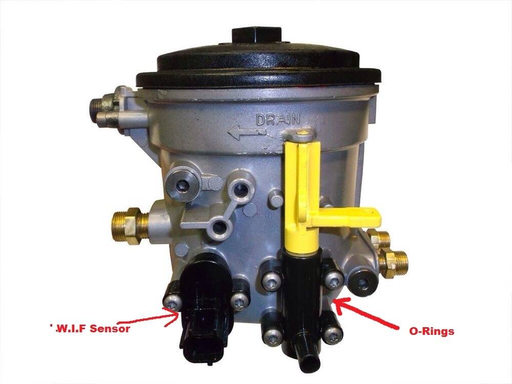

The dually is the 7.3L, yes?
Common fuel leak is from the O-rings between the water separator drain valve and fuel filter/water separator housing. Less common is a leak from the water in fuel sensor O-rings or the sensor itself.

The dually problem 1) was the inevitable hole in the metal fuel line rubbed through by the retaining bracket. .. seems just about everyone complains about that around 140,000 miles.
problem 2) the aftermarket turbo module is leaking diesel through its seams.
So, replaced the metal fuel line in the parking lot at Home Depot. Leak slowed enough that it could get back to the farm. Went after the remainder leak this morning. No parts on a Sunday for a 97 Diesel, so got a plug and plugged the orifice. The truck is no longer turbo, but can be driven back home from dad's. I'll order a replacement part and turn it back into a turbo boost in 7 to 10 days (as well as put in a new fuel filter since the fuel bowl will be drained- again).
