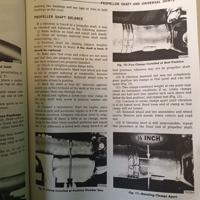

I was flipping through my 77 manual because it has better pictures and I came across a redneck balancing procedure straight from the factory. It made me think of this thread.
I have the service manual as well. This method is used to trace a vibration that may be caused by an out of balance drive shaft. So far all is good with no vibe's felt. Since this DS came out of a running vehicle, I'm going to assume at this point it was true enough and did not need extra weights. Probably more rare than not.
