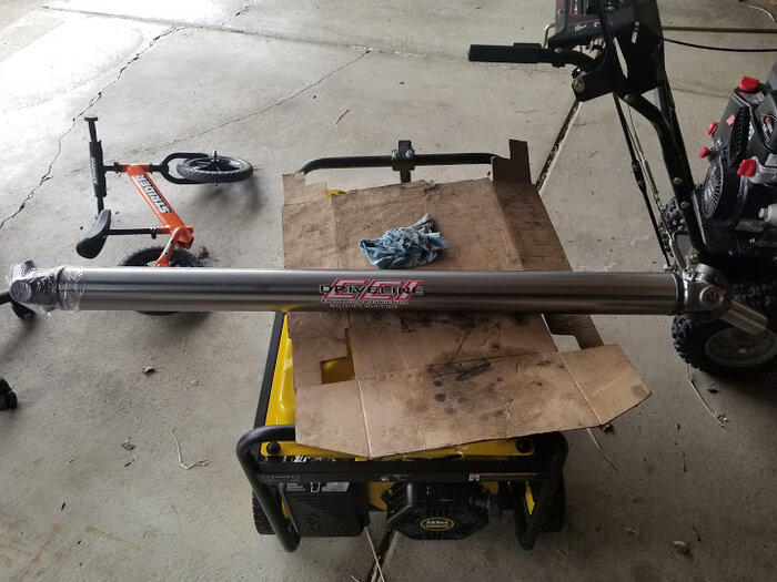

Get your measurement and call Strange.
They are not as expensive as you might think , their turn around is plenty quick and you are getting the good stuff.
Send them your trans yoke to balance.
They don't sell a 904 Yoke , so I had to send them my Mark Williams piece when they built my first one.
That's been nearly ten years and they still don't offer one , so the demand must not justify tooling up for one.
But they are very easy to work with.
I've bought three others since and am very happy with the results.
