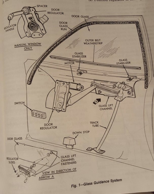

Here's the layout. You'd have to get a donor crank and put it in. It's possible that Chrysler put the crank assembly so it would just bolt onto the existing regulator holes but I don't know.
Well, I am hoping it's setup like it is on my Ramchargers, One has electric windows, one does not but the mounting holes for the hand crank are still there for the one with the electric windows.
This is more just a curiosity thing right now as that 87 Fifth Avenue that my wife picked up for me has power windows and I really don't like Power windows. And both Back Windows are Stuck in the Down Position. If that 87 is worth Fixing up (so that's two Headers I will need eventually LOL) then I plan to get rid of the electric Windows if possible.
Thanks for the Pic Capt.
