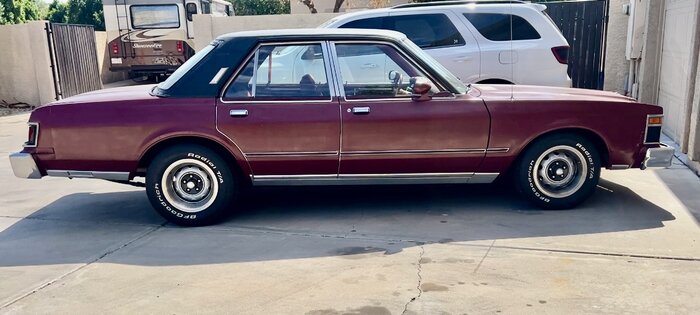

I removed the remnants of my 4 door vinyl top. A previous owner had cut the roof off but left all the vinyl on the A and C pillars and around the trim. I took all the trim off, took the vinyl off, cleaned off the glue with a razor blade, sanded it, cleaned it, put 3 coats rustoleum rusty metal primer on, then 3 coats matte black stripe paint. Then I reinstalled the trim.

I did the same thing with my sedan and the trim fit better than I thought it would!
I will be going back and re-doing the roof and filling everything then coating with Raptor liner to look the “vinyl” part from afar. ( I care less what people think, I just want it to be presentable as it is my daily.
