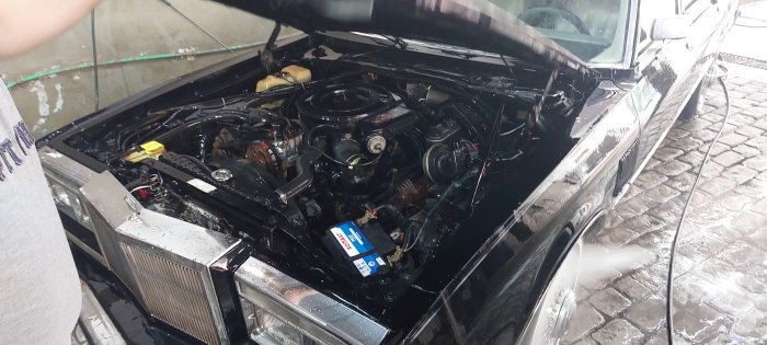

I just got my engine bay cleaned after sitting for a good year or two, pressure wash with degreaser and some soap on a brush for specific places. All I did is wrap the carb and distributor and it turned out shiny

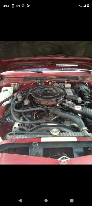

Taken right after I first cleaned The Cherry Bomb's engine: Purple Power, a good parts brush and a power washer, before this the entire engine and everything else under the hood was covered in heavy grease...Screenshot_20240718-041401.png
