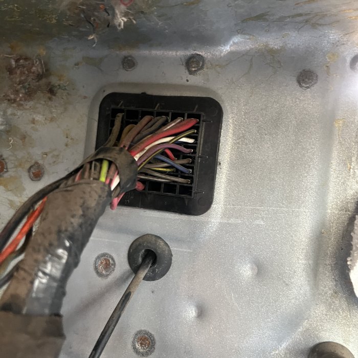

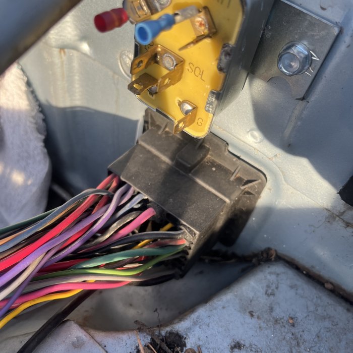

Jan 26, 2025 #1 Lightning II Well-Known Member Joined Sep 24, 2020 Messages 239 Reaction score 108 Location Augusta, GA Is there an extra clip on the main harness plug at the firewall? I’m having a bit of trouble pulling them apart.
Jan 27, 2025 #2 80mirada Well-Known Member Joined Sep 3, 2012 Messages 1,657 Reaction score 672 Location Wisconsin, Fort Atkinson There is a screw in the middle of the plug, on the interior side of the plug
Apr 1, 2025 #3 Lightning II Well-Known Member Joined Sep 24, 2020 Messages 239 Reaction score 108 Location Augusta, GA This is a delayed response, but I wanted to say thanks! I couldn't for the life of me remember that screw was there. On the plus side, I have an interior harness that's 99% intact. (save for the dome light wiring)
