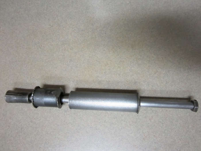

What is this used for?
Looks like a stud/guide pin puller for cylinder heads/blocks and flywheels.
Winner Winner Chinese dinner.

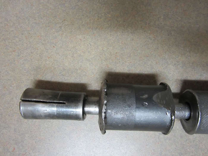

Dowel pin puller. There are several ends to choose from for the size of dowel pin you are pulling. You place the puller over the dowel pin. You pound the collar down until snug and one quick yank up and the pin is out of there.
