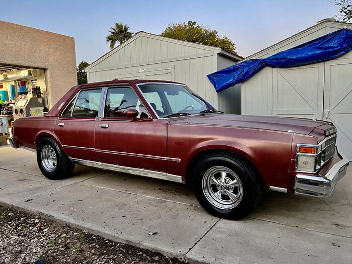

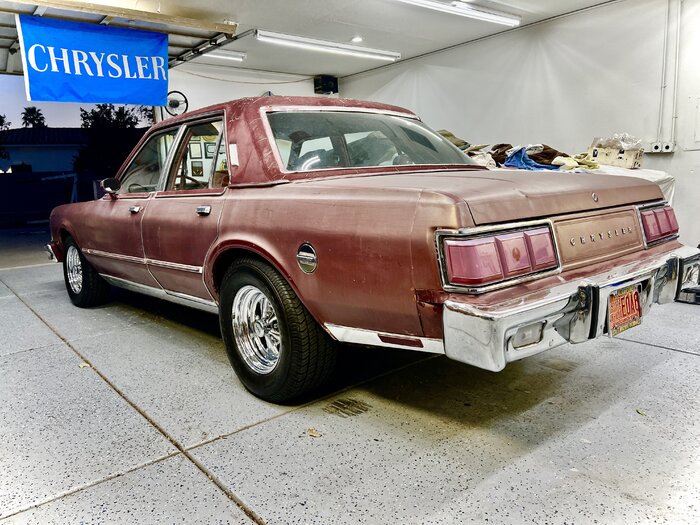

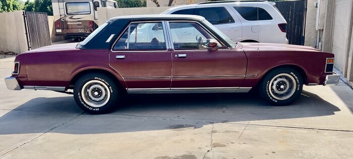

Funny, once you get a car reliable and going as a daily you kind of forget about it… It’s blended into my daily life so much I’ve almost forgotten about this thread!
I did remove the padded top to discover as I expected… Rust… it’s mostly scale and pitting but no huge surprises.
I scraped and wire brushed the entire roof, removed all moldings and trim and cleaned app of the channels around the windows.
I then coated the entire roof with a rust inhibiting semi gloss black paint to keep what’s there at bay.
I prepped and painted all of the surround trim that once was red and matched the vinyl black and reinstalled it all with new trim clips where needed.
I like the look for a temporary quick one day fix and it’s held up great for at least the last 6 months.
I’m planning on DA’ing it down, filling the pits and seams around the C pillars and window plug and body working the roof and using a textured coating like Raptor bedliner so it will last and look a lot like a black vinyl roof.
