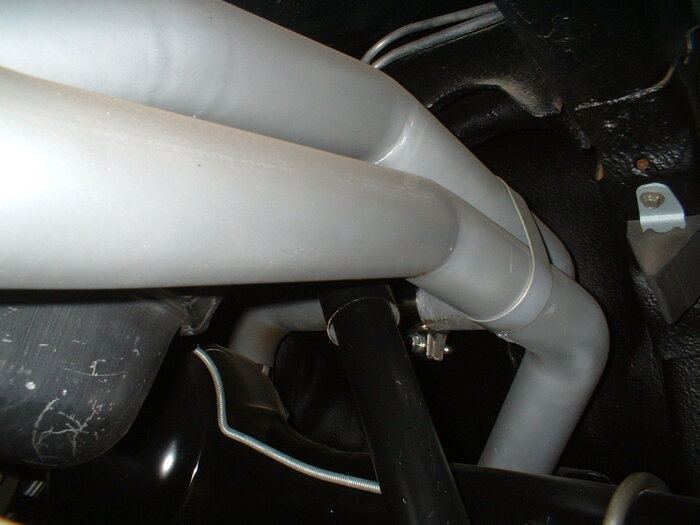

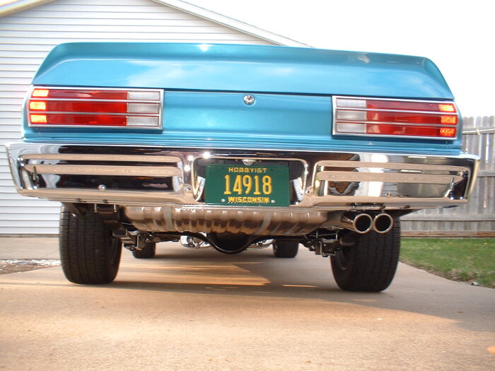

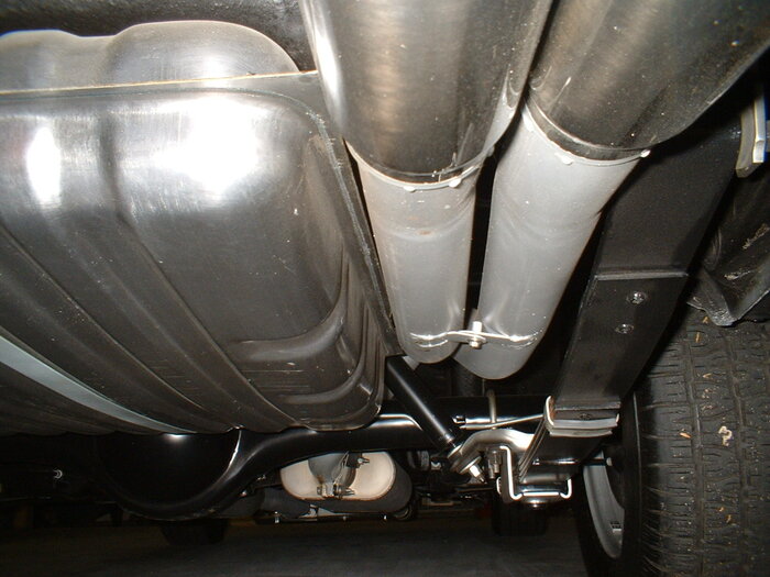

Aspen500 ... if I bring my 87 Fifth Avenue up to you, would you wave that magic wand you have and make the underside of it as sweet as those pictures you posted?

Thanks for all the response about the dual pipes.I JUST had a look at the underside of the Volare.Didn't realize there is no room.Aspen 500 thanks for the pictures.(I really wanted to have it look like factory duals,BUT I guess that is out.)Thanks again,Ya'll.

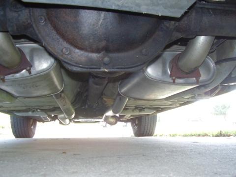

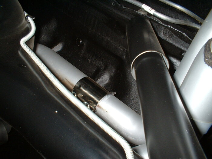

You can move the gas tank over if you really want the factory-ish look of duals. On the 4 door sedans, you just pop out the plugs in the trunk so the tank will push up real close to the bottom of car so you don't have to get longer straps or bolts for straps. Might have to do same on wagon, I'm not sure. You have to then extend the fill tube using some fuel rated hose from any auto parts store, and two hose clamps. As Duke5A wrote, then you shift tank over one rib toward driver's side. Now you have enough room to run 2.5 inch pipes, one each side. That's what I have on my '89 Diplomat. I know this pic doesn't show tank, but it's only one I have, but this is Jegs A body exhaust kit with tank shifted.

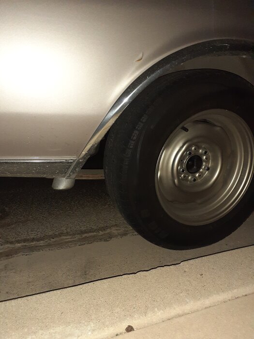

Made my duel exhaust for my 88 5th ave my self from pre bends bough at the local parts store, used mufflers and spare pipe. Exits just behind the rear wheels like an 80s Malibu looks ok. Sounds great. It is smog exempt though. No cats.

Bad picture. But works well and does not gas out interior. Plenty of room behind axel gets close to the filler neck on drivers side. Had to cut some inner fender to get tips to aim correctly.

Interesting. I did my '80 Aspen A38 and my '89 AHB the same way. Popped the trunk pan plugs out which gives just a bit more room to push the tank flat against trunk, then just barely enough room to use factory straps to re-fasten tank. Then lengthened fill tube with rubber fuel rated hose and two clamps.
