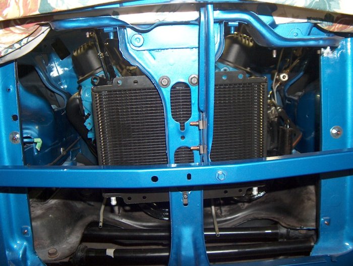

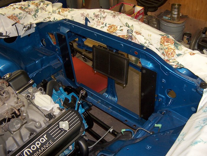

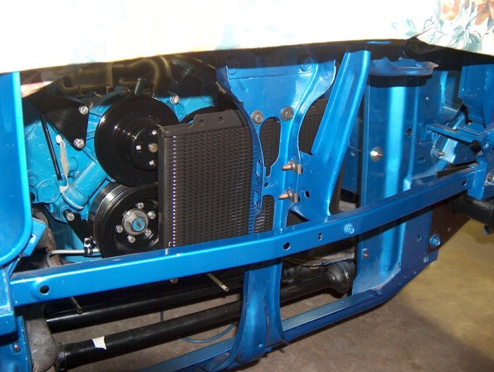

Here is what I have, but for the life of me though I cannot find the part# for that cooler!
Mine still has it's factory AHB external cooler. But I use the B&M cooler for my external engine oil cooler and it's high quality. I used all braided steel lines and an fittings and it's 100% leak/seep free.
The stock AHB cooler that mounts on the core support? Have a pic of it?
