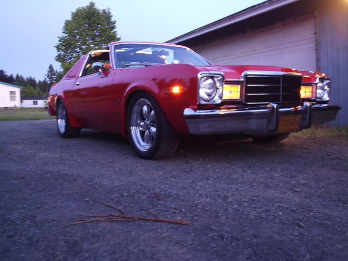

Hey friends.
I got that repro front spoiler from ebay last year. This is the non supercoupe one, since you need the supercoupe wheel flare to make it work- which I don't have. I notice F body cars with the front spoiler not installed, and wonder if it is prone to damage going in and out of drive ways. How should I set the front suspension? I guess I'm asking guys who have this like Bremereric. Could you take a measurement or a few of how high off the ground / how much clearance you have from the bottom of your front spoiler? Or a measurement of the center of the wheelarch to the ground of one of your front wheels- since none of us run the same tire and wheel combo. I didn't really want to jack the front end to high up. My other fear is I will not be able use it. My SS/T ram lost front spoiler privileges when I lowered it a foot and it could not get out of the driveway.
thanks

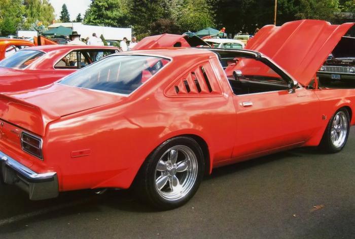

non supercoupe front spoilers are found on aspen r/t and plymouth roadrunner superpak cars only. supercoupes are their own beast and the flares, wheels and spoiler are all unique to the supercoupe. They dont need supercoupe fender flares, they need the fender pods (see photo) if you car is lowered it is definately gunna get beat up if not broken. they have some give but not much. my dads car (in picture) is quite low hense why the front spoiler was never put back on. My dad's car is a true superpak car with m55 t-tops.
