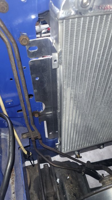

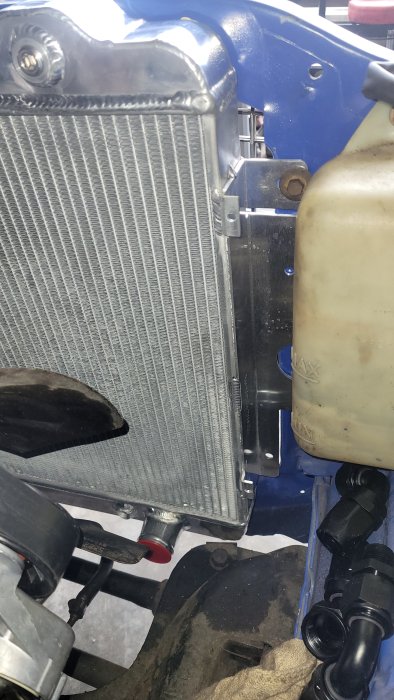

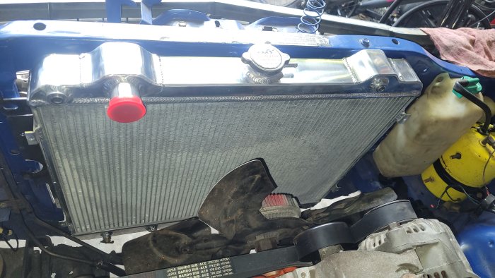

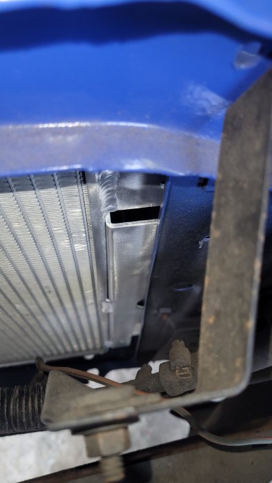

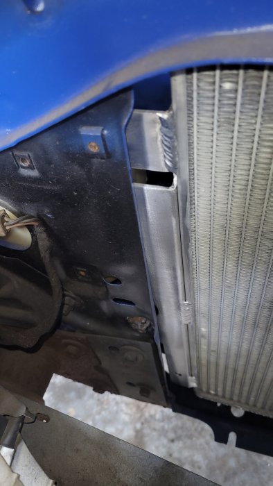

i read before that a rad for a 1/2 ton dodge is almost a bolt in. just a couple new holes in the rad support.
anyone done this? looking for an aluminum rad.
I think it's the truck and van one that fits or with minor work, if it's going into a V8 car.
well mine is a 26 inch, same as the other cars with that size. i read that 73-76 a-body 360 cars use this size and fit nicely.
Aren't some dodge truck radiators of that era thicker and some taller than the F/M body car rads? That would be the thing I'd watch out for; whether or not there's enough room to clear the fan and the hood to close
1976 Dodge Dart V8 Engine #CC499.​
only $260. fits enough for me. gonna need to drill a couple holes, but i think it will work
