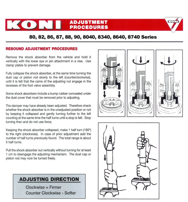

So I stepped back. I looked at my KONI setups, now I could firm them up b/c the t-bars were capable of better controlling the chassis movement. BAAAM!!!
do you have the part numbers handy for those shocks? sounds more like what i need
These KONIs have been out of production for a long time now, at least AFAIK, but here they are:
80-2289 SHOCK, Shock absorber, adjustable, FRONT (set)
80-2340 SHOCK, Shock absorber, adjustable, REAR (set)
I've attached the adjustment procedure for FYI.
What I would recommend if you want adjustability is that you look at the Viking (www.vi-king.com) shocks.
They have numerous options, pricey yes for sure, but that level of flexibility isn't going to come at a different price point.

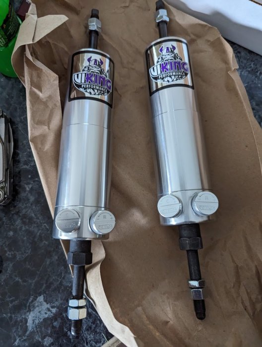

Viking has active part numbers for front and rear shocks for our cars. They're $250 a piece and worth every damn penny. If you pair these with a set of FF 300# bars it will completely transform how your M handles. Like a modern car.
B2001. You'll be happy. I have mine adjusted six clicks on both rebound and compression. They build them to order. I had mine in a couple weeks.
You'll have to yalk to FF about the torsion bars. They don't make runs very often. I bought mine 11 years ago.
Toss a factory set of front and rear sway bars on the car and frame ties to complete the package. It's insane how well it handles.
