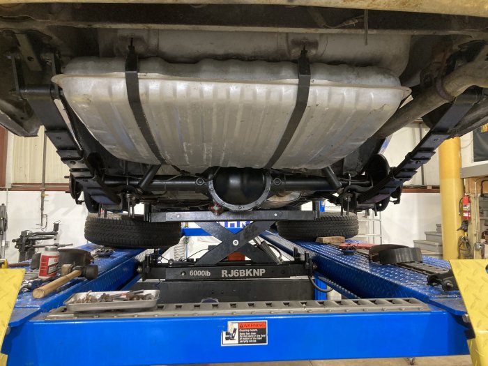

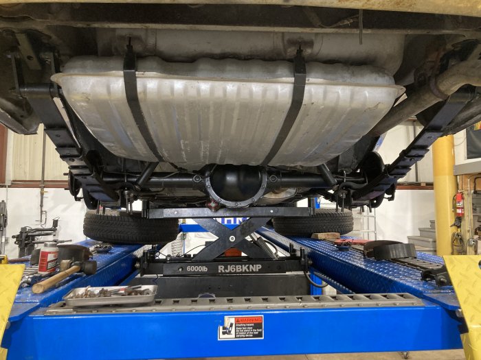

Just about done. Sending the driveshaft out to be cut.
Like they have a little splay in them? I thought that’s what I was seeing but figured it was just optical illusions
Like they're too long and they angled them to try and take up the length to make them tight
Different from the old ones for sure, I thought maybe the length was excessive, but that's not a big deal to me as long as everything works the way it should. They called me in about the driveshaft and I told them it needs to be cut and balanced to fit, so they're sending it out. Looks like about an inch needs to come off, not much. I didn't notice a splay in the bolts at the time, but I didn't wanna take up too much of their time either, but I'll get underneath to look some more, maybe take some more detailed pics when I get it back.
you don't want any play in the u bolts.
Yeah, I'm with you guys on the U-bolt thing. Keep in mind, my definition of the 'proper' U-bolt is the flattened & serrated OEM setups...which I think have dried up a long time ago (I'm talking Mopar part# 3845264, U-BOLT, Axle U-bolt (clip), 4 3/8" length, 7/16 - 20 tpi).
Either way, these need to be tight and seeing as they have a bit of a lean to them I would worry about them straightening up all of a sudden and creating slack!!!
Have the shop explain this install to you and make sure it makes sense.
