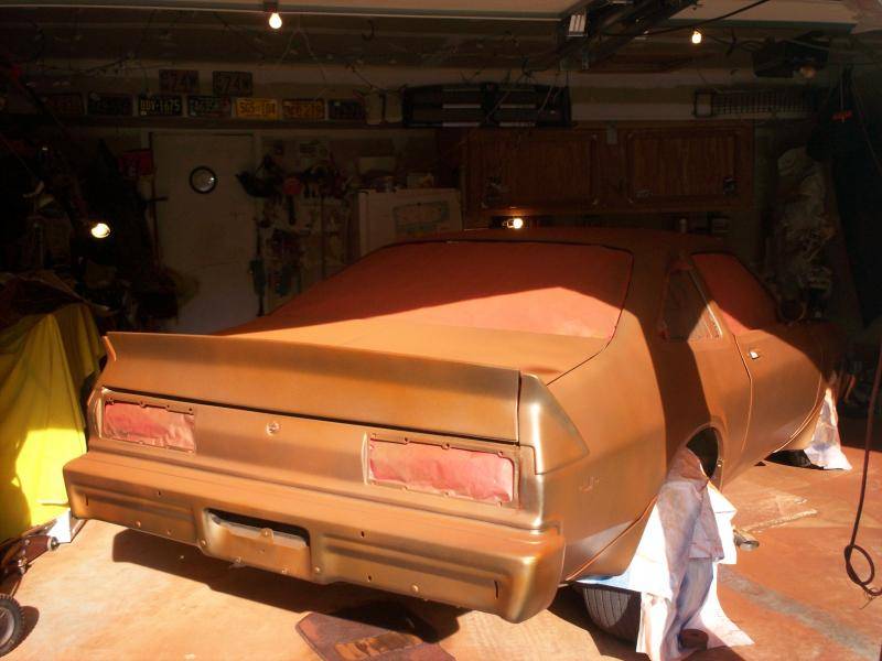

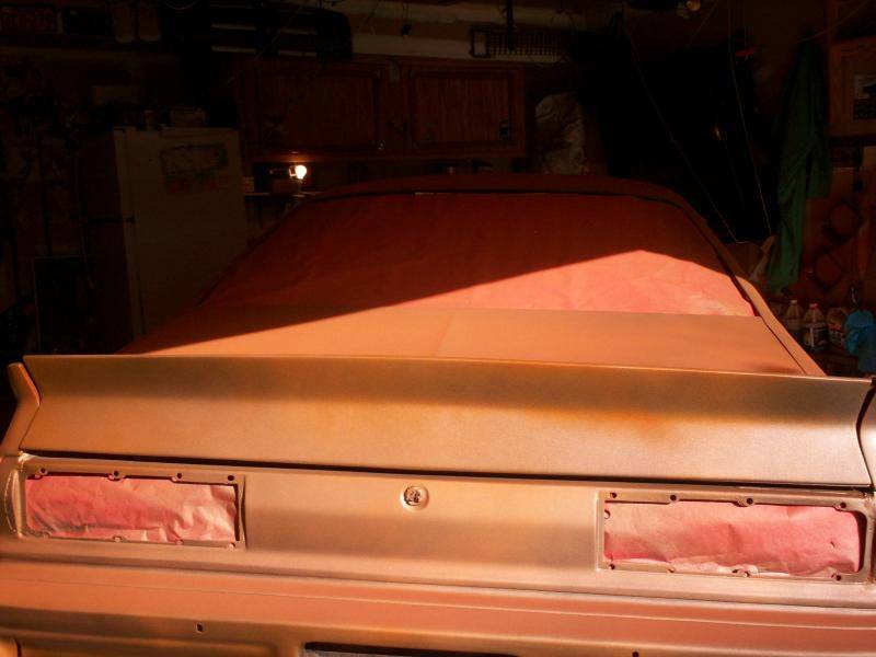

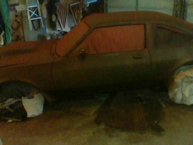

My phone sucks for photos. There is still a nasty chemical cloud in there, so I'lll head back into there tomorrow with the camera. Sweat from my hand dripped on the trunk in 2 spots, so I have to re-shoot the trunk. The candy goes on real thin- like water and that is right from the can into the gun with no thinning. I ordered 3 more quarts and will get it on Tuesday. I'll hit the trunk with scotch bright to address the sweat drips. Other note- the Duplicolor candy has almost a sweet candy smell through the garage and part of the house. Definite nausea effect.

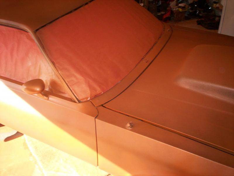

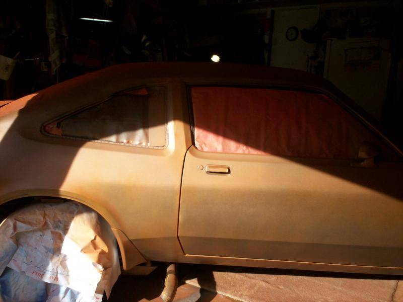

Better light. Sins revealed so far: Plastic burrs in the window louvers and the paint layed different than the rest of the car. Sand and repaint of the louvers. All the top panels need tack cloth bad. There is a 1/16th of paint dust on the hood, trunk and roof. a lot of folks use rubbing alcohol- I 'll stick with the tack rags. back to the garage
