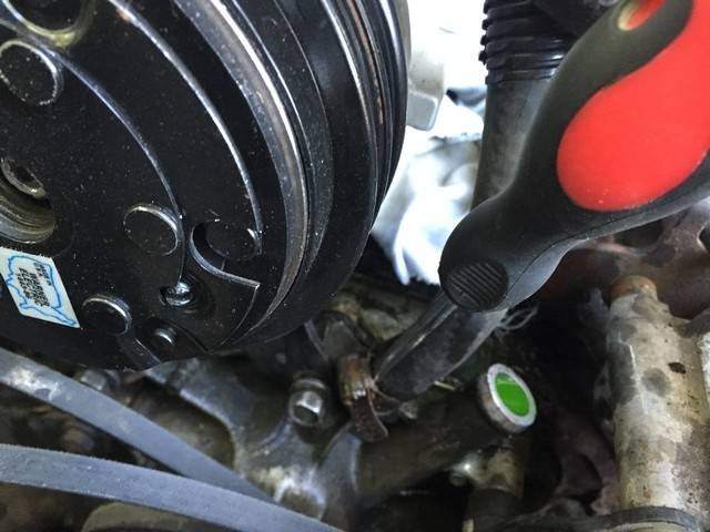

Q1. What kind of clamp is this?
Q2. Is there a better way to remove it than using long nose pliers and prayer?
Q3. Is there a reason that I have both the clamps above and the worm? clamp (screw clamp) on the same hose but at different ends?

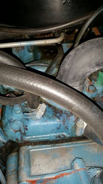

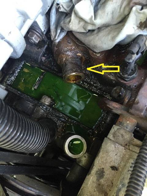

Q5. I couldn't find enough detail diagrams in my service manual so I don't know the name but here is a picture:
The short 90 degree elbow hose that goes from the opening near the thermostat (arrow) down to the opening at the bottom... that hose. What is the secret to getting the new one on?

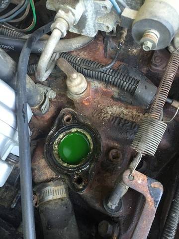

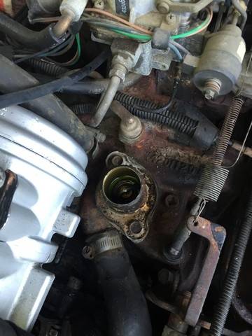

Q6. How long between times changing out a thermostat and gasket? This gasket was gooey and just about non-existent.

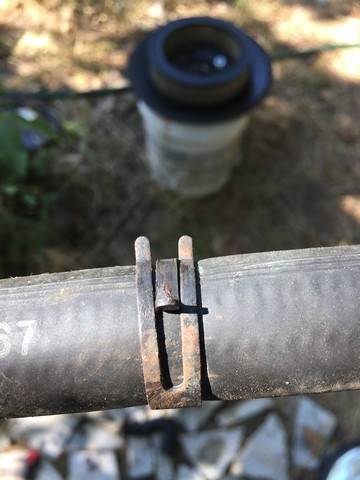

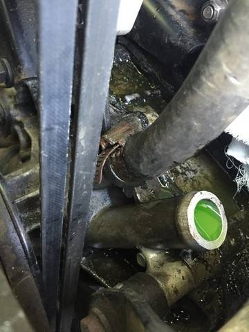

Q7. Why did this clamp rust but other one near it didn't?

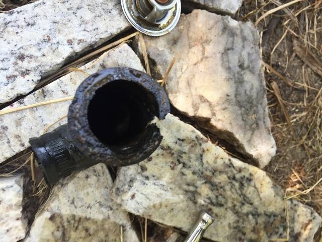

I backed the screw all the way out and the rusted clamp didn't move. Used a hammer and screwdriver to get it carefully levered off.
Q8. How often do you replace hoses?
Q9. Is it normal for the ends of the hoses to have to be cut to get them off the car? Some ends were very brown, none were brittle, but a couple had a bulge on the up side of the clamp.

That 3 prong clamp is a factory hose clamp, and they come off with pliers just fine. They are generally not available in the after-market in favor of the screw clamps.

Hoses, and thermostats have improved greatly since the 70's. Now they can both go for many years without issue. As long as hoses feel soft, and flexible, leave them alone. The gauge will tell you when the thermostat is starting to fail.

The short 90* hose is the bypass hose. When the t-stat is closed it allows coolant to circulate through the engine while bypassing the radiator. The secret to getting it on is lube the insides with coolant and put it on the manifold, then bend as needed to fit to the pump. They can be kind of a pain sometimes.
Yes, it is normal to need to cut a hose to remove it when it's been on there for many years. They bond themselves to the fitting basically and in some cases, slitting is the only way it'll ever come off. Sometimes even then it won't:eek:
Spring clamps are preferred to worm gear. The spring clamps keep constant pressure no matter the temperature of the hose or age where the worm gear ones tend to get loose over time and usually dig into the hose as well. Plus, the spring clamps just plain look better:) You almost have to go to a car dealer to get new ones of the type you have though or a resto supplier. Don't know of any parts store that carries them.

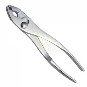

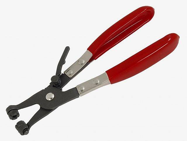

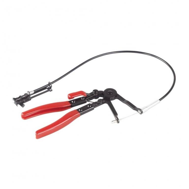

Better than long nose pliers is the correct spring clamp pliers OR a wide jaw regular pliers that'll grab both tangs on the one side.
The one clamp rusted probably from either coolant seepage over the years or it was a lesser quality clamp to begin with than the others.
Spring clamps. There is the flat version and a wire version.
They also make plyers and tools made to remove/install them. I kinda like them better, because with correct tools, they are faster and more likely not to leak afterwards.
That said, you can’t find those clamps just anywhere.
They can also manufacture the car faster with spring clamps.
The first two are lockable.
Some clamps are installed to engine before engine is installed. Some hoses may come from part supplier with clamp pre-attached.
Mentioned earlier, that is the coolant bypass hose.
“What is the secret to getting the new one on?”
Holding your tongue just right.
The gasket - when it is leaking or if needed removed for something else.
Thermostat, when it quits working - which is not often. Those thermostats are pretty reliable.
Be sure to clean the thermostat bolt holes with a tap/or thread chaser and make sure they are dry before bolting down. A bit of light Loctite (blue, I think is the color) will help keep corrosion down.
Most hose clamps are made of stainless steel - but not all are. Also, if coolant gets in one long term, it can make 'em rust.
If I’m replacing a heater core, for example, I will plan on cutting the hoses off.
If I don’t need to, then great - they will get reused.
You said “bulge on the up side of the clamp” - is a disaster just waiting to happen.
I buy heater hose by the box, to use in my fleet, or other cars I work on.
A quote I give people: “Heater hoses happen”!

So the only flaw in my set up was not cleaning out the bolt holes well enough. I also found the missing bolt (since replaced) that fell out when I removed the a/c compressor the first time.

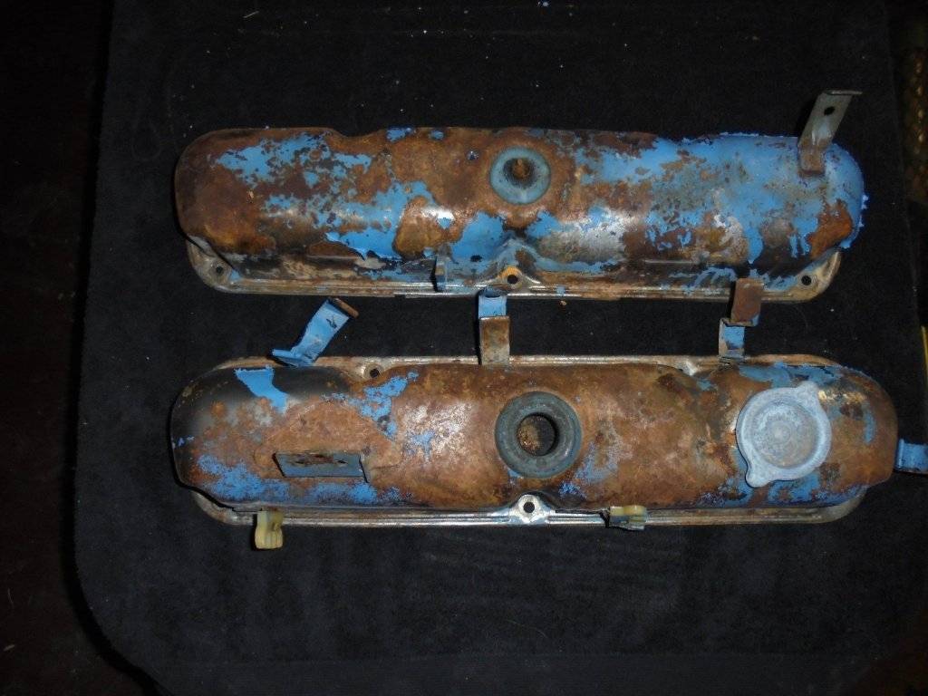

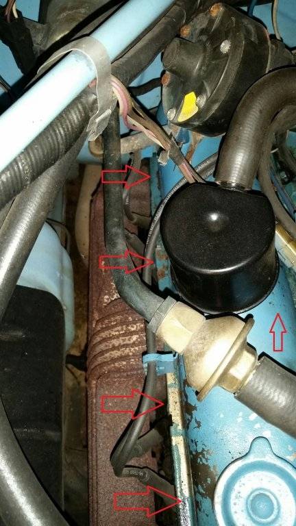

The factory didn’t put much emphasis on engine paint – and not uncommon for areas not to get painted or other areas that got lots of paint (the exhaust manifolds) for no reason.
If building an engine, using primer and a bit of time, makes for a much better paint job.
The tin-wear (valve covers and oil pan) are real bad for factory paint to stick on.
I wouldn’t be surprised if the original tin had a coating of oil (for stamping or manufacture) on them before painting, and we all know how well paint and oil mix.
I suspect that maybe why Chrysler went to black for engines, so paint wasn’t as noticeable (which is a horrible color for engines), in my opinion.
In this picture, working from bottom up, you have the water pump (barley seen), timing cover (has a flat dish like top surface), intake manifold then air cleaner (top).
Also seen in this picture is the coolant bypass hose and both heater hoses. Missing in this picture is the A/C compressor (this vehicle car came from factory without A/C).
You might not be able to see, but the front most bypass hose clamp was painted blue from the factory.
Valve covers. Note: paint on these is typical to what I see sometimes. Picture swiped from eBay.
Note: I have seen oil pans and valve covers rust from outside in, so a lack of paint is not a good thing.
In my opinion, a good painted surface is also easier to keep clean.
the top and bottom picture is from my '77 Volare 318 with 37k miles on it. The red arrows are missing paint (in case you can't see it.
There are some differences between the years (paint color, breather color and shape, intake is different, Lean Burn and a few other differences - but most is the same.
3,783
1,148
So everything I'm seeing on this engine is normal although not optimum for long life.

1,492
basicially, yes.
No way to prove it, but I really think the factory didn’t de-grease the parts before painting.
Most of the engine rebuilds I’ve seen, the paint job is in a way different class.
Also, paint can be another layer of sealer at a gasket surface – so when painting an engine, be sure to give the gasket edges an extra shot of paint.
