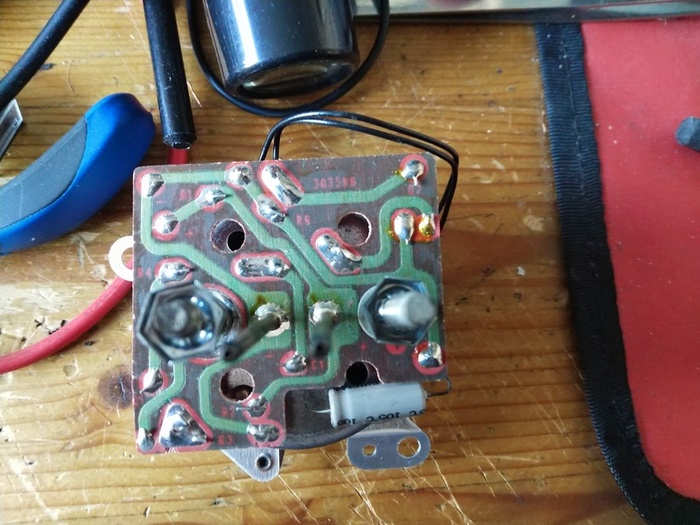

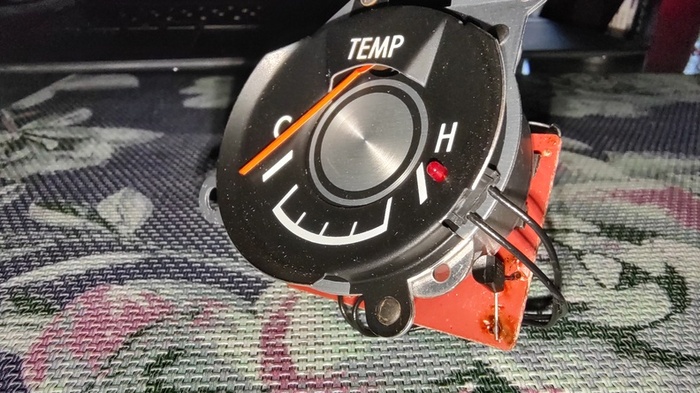

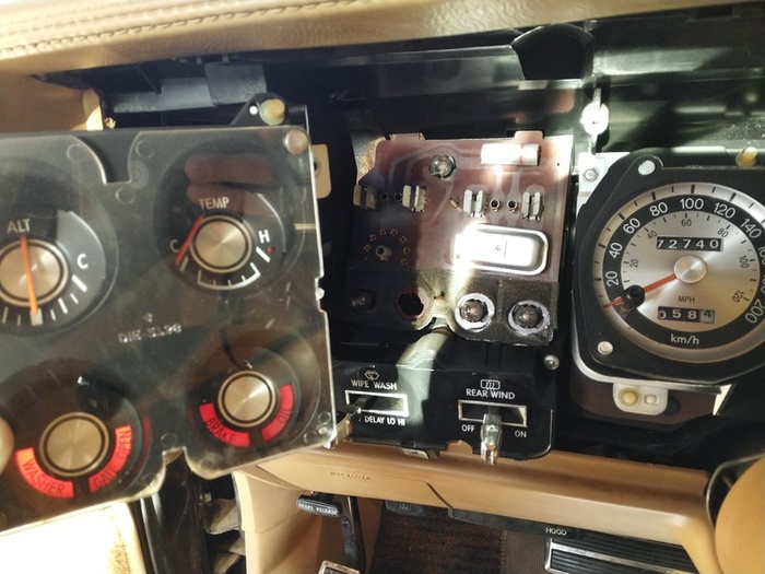

The red LED in my temp gauge was flickering all the time. The sending unit and the gauge tested just fine.

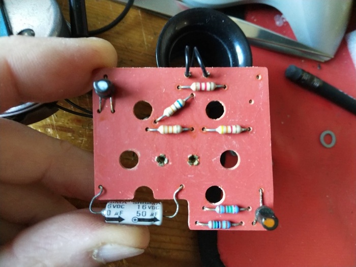

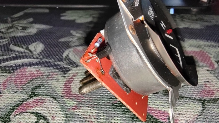

It turned out that after 40 years the condenser on the little printed circuit right behind the gauge (not the big one!) was gone. It obviously dried out and had almost no capacity. It's the gray part on the lower left on the last pic.
Following procedure to replace it - as there are 2 transistors, be careful with static charges to not kill them:
- carefully remove Dash bezel (8 screws, 4 upper, 4 lower)

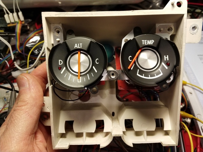

- remove 2 screws (right upper and left lower) of the Ammeter + Temp Gauge sub-cluster
- take this sub-assembly straight off (there's no more clips)
- carefully remove the 2 plastic clips to remove the cover of this sub-assembly
- remove 3 screws of the 2 gauges
- carefully remove temp gauge
- note polarity of condenser (the old one has arrows to PLUS! Nowadays, MINUS is shown on them), a photo with your smarty phone helps a lot. Cut wires of condenser short off printed circuit (leave a lead to solder a new one)
- carefully scrap clean the remaining wires (otherwise, soldering may fail)
- solder a new condenser with the same capacity (47uF, 50V is just fine) and obey the right polarity! (see above, take a picture)
- assembly in reverse order
LED goes on only, if coolant temp rises above a certain level (I tested only with my testing switch - with "full/hot" setting, it lights).
Be happy :)

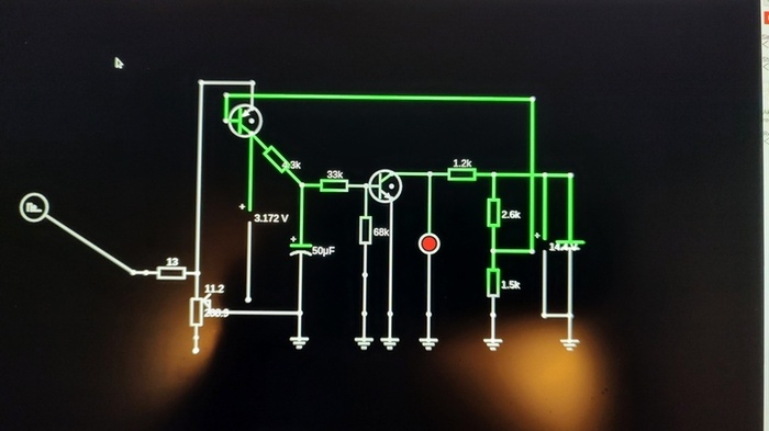

OK, I need to follow up on this one.
The new capacitor did fine the last 1.5 years. A couple days ago, the problem resurrected, unfortunately. Sometimes it did work as expected, and other days it didn't. Then, it was broke. The LED was lit all the time, the temp gauge worked flawlessly.
Re-examining the whole thing, nothing unusual detected. So, test the transistors - broke. :(
Checking for those types proved detectives detail-work. 2N5308 (a NPN-transistor) and a 2N5354 (it says GE5354, but - PNP transistor).
Not much information about those old types available. So, set up a circuit simulator, to find out how it works and being able to properly replace the transistors. It took me hours to find out, that both transistors are TO-98 case, but they have differnt pin layout.... :eek:
Replaced both correctly connected - and it works again.
Important information on this (found out with the circuit simulator): the circuit depends on the mechanical voltage regulator! If you replaced it with an electronic one (with straight 5V output for the gauges) it will not work, the LED will be lit all the time.
Difference is, that the mechanical regulator just switches 12V on/off like twice a second for 80 milliseconds. That is a big difference for the circuit - get a pulsed signal as input or a lower straight voltage...
I hope that this might be helpful for someone else
Here's the replacement transistors and the circuit in the simulation program.
