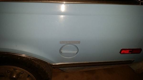

My ‘77 Volare wagon was begging for a pop up gas cap adapter, so I bought one.

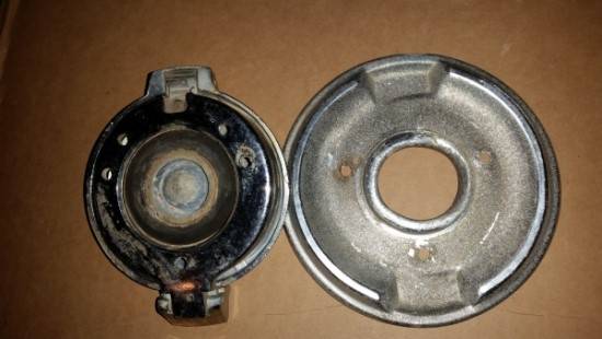

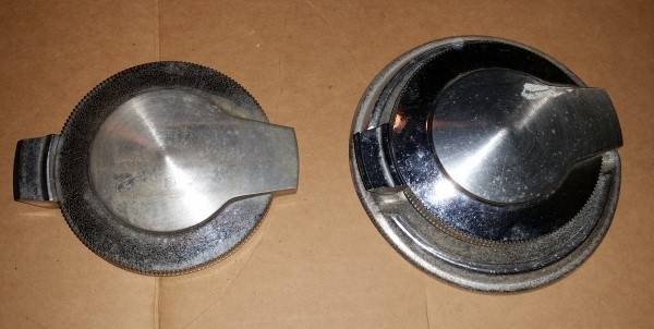

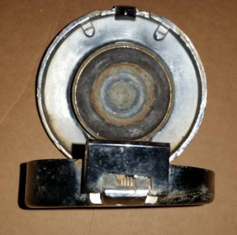

I had an old (and beat up) ‘67 GTX gas cap and trim ring, as well as a gas cap from my ‘68 Charger (which caught fire/burnt up 20-some years ago). All 3 pieces are not in good condition - but at the time, there were no repops available, so I hung onto them.
I was wondering about the trim ring, sense the ‘67 GTX, Belvedere and Satellite all used the same quarter panels - and screw on cap size is or roughly the same size - but GTX used the trim ring/pop up cap.

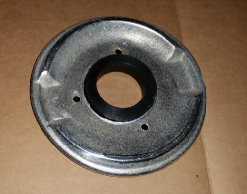

The GTX trim ring is not quite 5-½" in diameter.
You might not be able to see, but that aluminum trim ring is missing about a third of the sprayed on texture and is pretty much beat up. I figured that sense a pop up cap was going on, I might as well try the trim ring on for size.
Note: I will be purchasing a new repop cap and trim ring soon. Matter of fact, if someone is looking for a poor condition popup gas cap, send me a note, I have two.

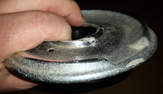

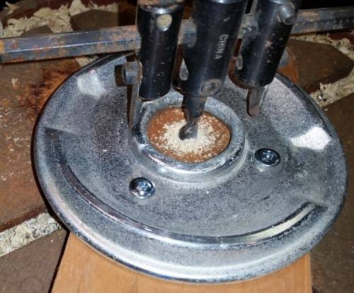

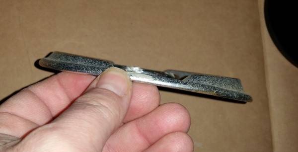

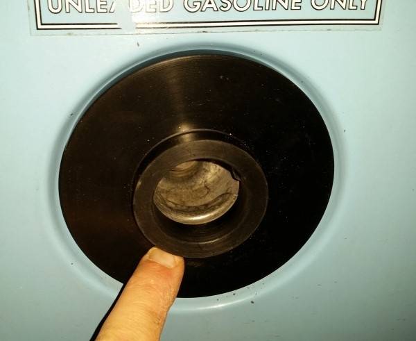

The first thing I noticed is the gas cap and trim ring are angled. Both are wider/thicker on lower edge than upper edge (see pictures). I don’t know if that is because bodies slope in - or what. The original caps always opened at the rear.

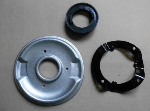

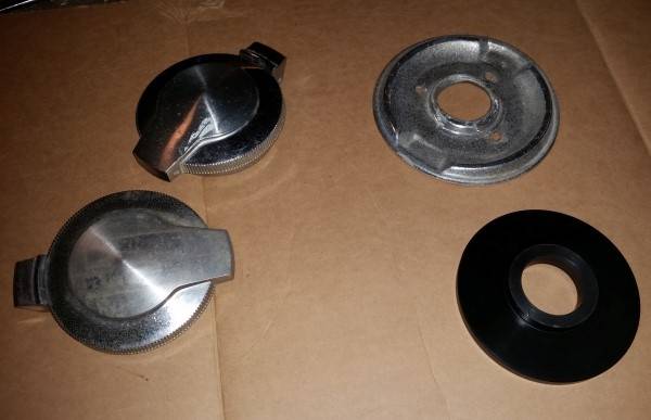

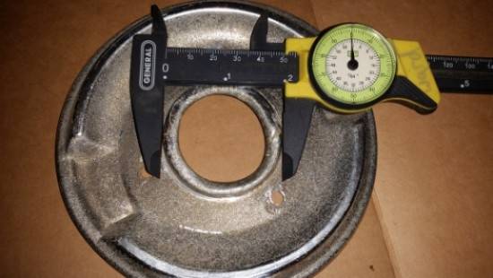

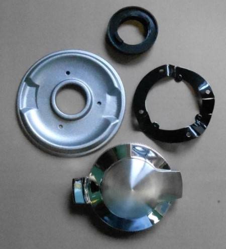

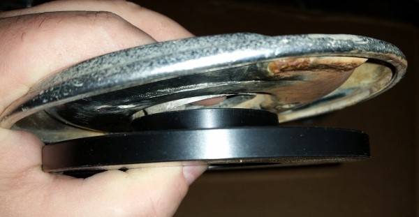

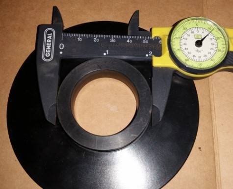

The adapter would not fit inside of the trim ring. I measured both and adapter is 2-1/8" outer diameter and trim ring is 2" outer diameter. My trim ring was beat up, so I went ahead and cut out the inner portion.

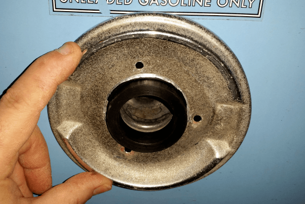

A mock installation shows, with a modified trim ring, the ‘67 GTX trim ring will fit and work on our F-bodies.
Now with that said, the trim ring fit flush all the way around the quarter panel - but had a slight gap where it mounted to the adapter (roughly 1/8"). That will pull in when it is screwed in - and I plan on using gaskets between adapter and car, and adapter to ring, so part of that 1/8" will be taken up.
The outer gasket wont seal anything, but it will keep the trim ring off of the vehicle paint.
My adapter will not need to be painted - for it won’t be seen with cap in place.
If the adapter could be machined down to slightly under 2" outer diameter as well as have corners rounded, the two items might work together without modification.
