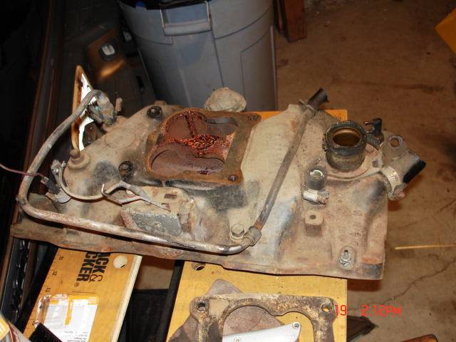

Got my used 4bbl intake today.
Mounting flanges appear to be good. Tapped holes also appear to be good. Lots of dirt and rust to clean up. I still need to get a kit to "Trash That Lean-Burn". Not to mention a carb. I'll be drip-feeding myself these parts as finances allow. I guess for starters I should pop the hood and note the differences (besides the obvious) between the old manifold and my replacement (notice I didn't say new).

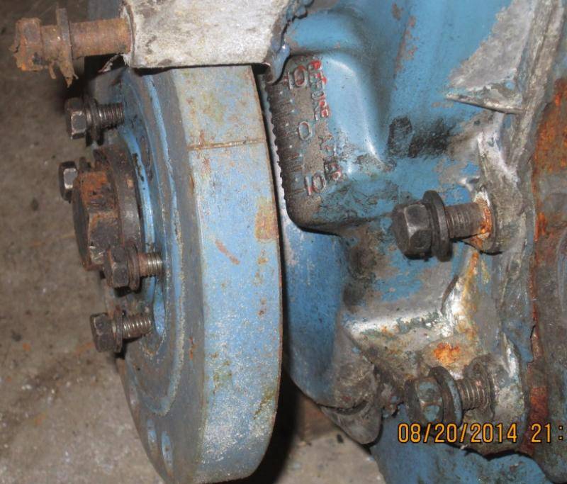

Fellas! I feel foolish! I was just repeating what my brother had told me in an email! I have a picture to send him and I'll post it here to. I didn't check my car after I read his email but my engine does have timing marks:

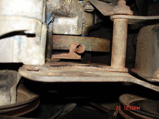

When I told my brother about this bit of humiliation, I had also sent him the same pic I posted here. He replied by telling me that the tool is called a "timing sensor probe" and it fits into the tube that aims at the harmonic balance. Can anyone verify this and is this "probe" something I need or can a conventional timing light work using a 318 spec?

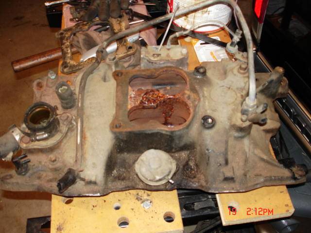

Another issue with the 4bbl intake after showing it to a friend of mine who used to work on old Mopars all the time: What is the tubular fitting down inside the manifold and the hole that is under the would-be carb? He's old school so he said he had never seen that before. At first he said remove the fitting and plug the holes, then he said maybe I ought to find out what they are first. Here's a pic:

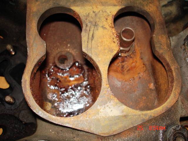

Ok, I'm back on my manifold again. The round hole on the left is intersected with the tube on the right. The strangely shaped EGR port on the far left doesn't appear to intersect with these ports. When I shoot degreaser into the tube on the right, it flows over to the round hole on the left. I've tried digging out any possible "plugging" from the EGR port to the round hole and I don't believe there is an opening there to connect the two. I have removed the tube on the right, cut off the tube portion of the fitting and getting ready to drill it for a 3/8" tapered pipe plug. I also removed the sheet metal plate from the bottom of the manifold to see what secrets lie underneath only to find an empty chamber. What was the purpose of the plate? Does it need to go back on? Should I send pics?
