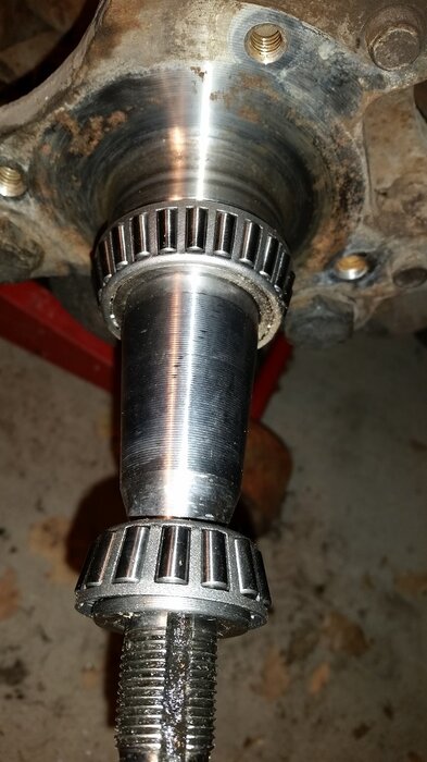

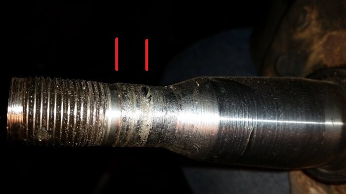

1,492
Sometimes it can take a lot to get one off. The big thing is to look at the spindle very well and also slide both (new) bearings onto the spindle before greasing 'em up to make sure there is no issues. If spindle and bearing surfaces are clean, the bearings should slide on smoothly with no hangups and with no play.
If you do have a spindle with any small nicks or burrs on it, sometimes they will clean up – but most times no (can't be salvaged). If you attempt to clean a spindle – be sure to clean it VERY WELL afterwards or those metal shavings (and abrasives) WILL make their way into your new bearing.
Here are a picture of a bad FMJ spindle (damaged bearing surface):
I see a lot more problems with the smaller bearing - but have seen damage at either end.

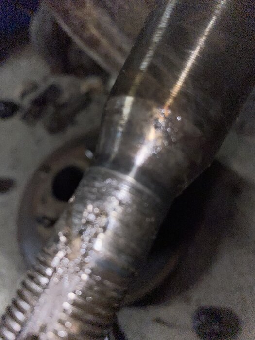

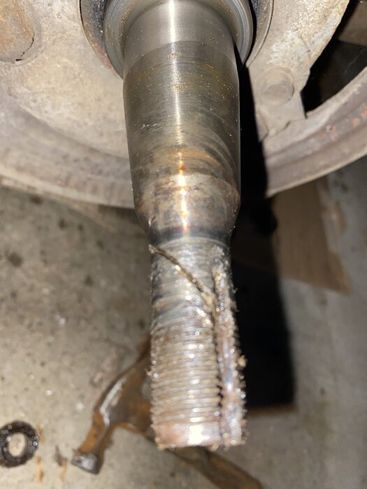

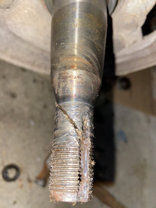

So onto the passenger side, which of course came off with no incident, wheel spun normally, bearings look ok but... I’m guessing this is not a good spindle ??? Uggg! This project!
1,492
Definitely looks like an accident waiting to happen.
I concur.
It reminds me of seeing a tire going down the highway, then looking back to see a multi-car pileup, with lead car missing the before mentioned tire.
