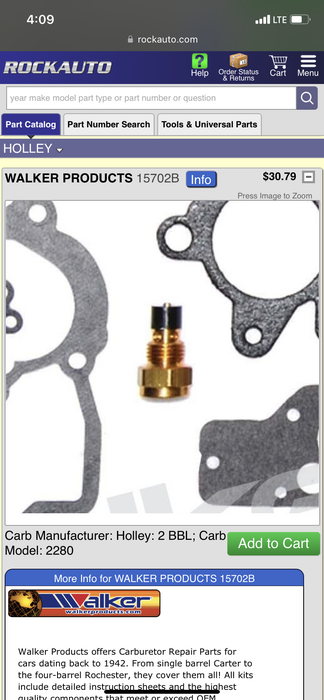

I found it to be the fuel fitting
This little bugger, do you know if I can purchase these from a part store? Could I remove the little black piece to swap onto a different nipple?

When tightening the fuel line to the carb make sure you hold the fitting. It houses the float needle and any movement changes the float level.

Are you running standard modern gas which may contain up to 10% Ethanol or are you running Ethanol-free E0 gas? I had a similar flooding issue due to a combination of the 10% Ethanol gas and a plastic cap on the float side of the float needle not being ethanol compatible. The cap swelled and caused the needle to get stuck open causing flooding like you describe. I removed that cap since the original did not have one, and flooding stopped. The rebuild kit was supposed to be ethanol compatible, except for that extra plastic cap. Now that E0 is available near me, that's all I run.
