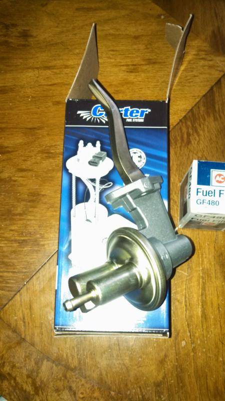

Monkeyed
Apr 3, 2014
701
76
West MI
look what the car part fairy dropped off today!

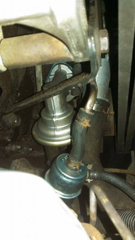

Monkeyed
Apr 3, 2014
701
76
West MI
Look ma, no leaks!
took about an hour monkeying with it before I figured out that it has to be flush with the block to clear the alternator bracket..
Runs ALOT better now! First it started and actually stayed running! I used to have restart it 4, and 5 times before it'd even idle. THEN I actually got it in gear AND out of the garage AND up the driveway!!!!!!! I drove around for a bout a half hour, city, country, highway, didn't die ONCE!! stoplight it idles so smooth, purrrrrs, then gives a little split second shrug, then smmoooooth again. used to have to pump it and floor it to get it to accelerate, now I can use 100% of the go pedal!! still a touch on and off trying to hold speed, not as bad as it was, doesn't herk and jerk, just a little surgey (if that makes sence?) If the mileage is closer to what it should be, I'm not going to be too worried about it.

LSM360
Nov 28, 2011
864
346
Melbourne, Florida
Well done, and that was the way to go; a new Carter instead of a junk hit and miss brand like hairtex or dormant or whatever. Nice job.
