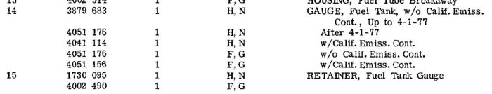

There was a mid-year change in ’77 for F-body (H, N) for fuel tanks and senders.
“F, G” are for M-body

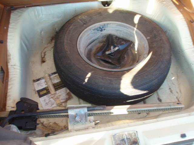

This is my early ‘77 (wagon) trunk floor (with hump style tank):
Notice the tire hole is round and won't fit anything more than a tire.

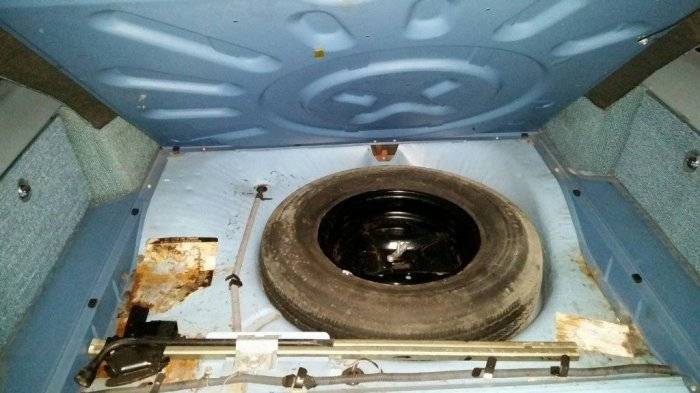

This another forum members (wagon) trunk with the late ’77-89 trunk floor:
Here you can put lots of things along side of the spare tire.
