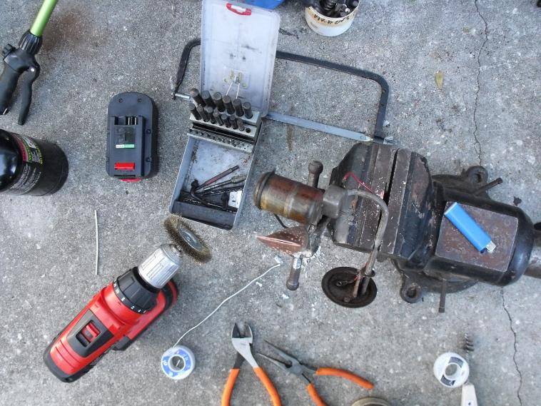

Mine fell apart, I took it out and cobbled it back together and I'll be damned I can tell I have gasoline now... usually not enough, but it works. the arm had to be soldered back on the pivot shaft but we-be-jamin.. I had pics somewhere. . . home-made pick up screen*hA!*
