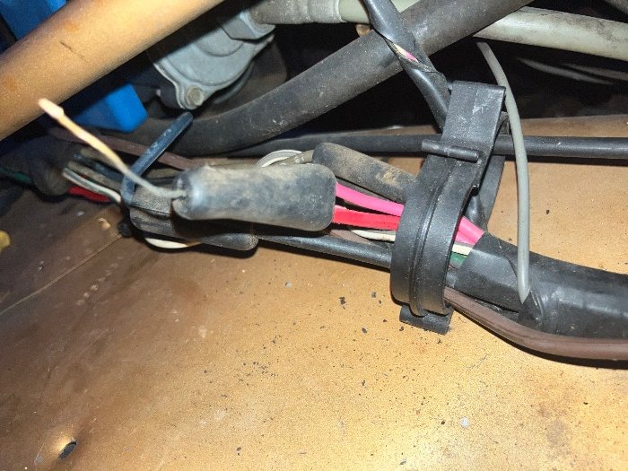

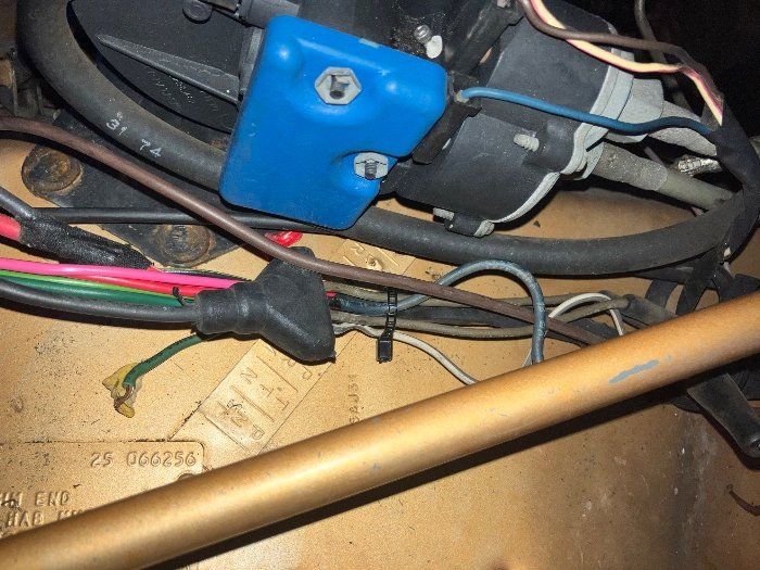

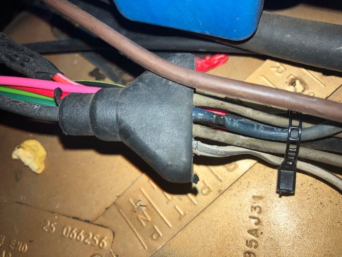

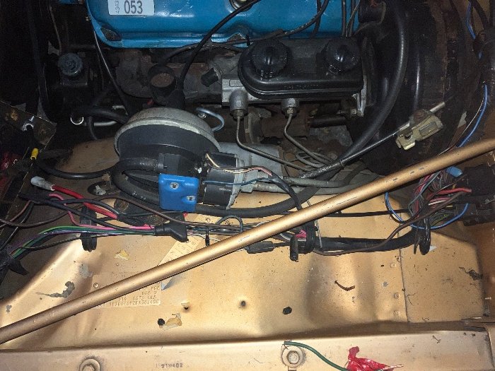

The fusible link in question is on the left front wheelhouse. (See photos) and is part of a group of links the combine into one.
The one that blew obvious has something to do with ignition—as I do not even have crank with out it.
Also unfortunate, it burned so completely that no wire exists where it entered the factory plastic splice.

If you find that wasn`t the short that caused your blown link then I would check the ignition switch connector at the the base of the steering column. Many times they melt and short out and cause problems like yours. I would replace with a fuse link if possible. Also make sure you use the correct size link wire when replacing . My understanding is a standard fuse won`t work well. Some people have used a slow burn in place but I have never tried one. I have seen fuse links for sale on ebay so you may want to check there if you can`t find any locally.
You can try a fuse but they used to use fusible link because they don't blow like fuses with quick spikes. Oddly they make the fusible links harder to replace like that. You can get them at Napa and some other part stores.

I was able to find the likely culprit—some melted insulation on a wire that I should have routed better. Upset with myself for being careless.
Was able to replace the fusible link and we are running again. Only driven about 20 miles or so but all seems well.
I did what I could to repair it as close to factory.
