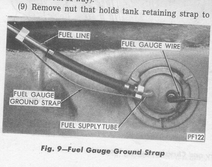

Often the problem is a bad ground. Did you replace the ground strap when you did the tank?
It spans the rubber line on the fuel line to ground the things. Guage won't work without it.
I dont think I replaced the ground, I figured like almost everything for our cars replacements are near impossible to find?
Your car should have a separate ground wire that goes right to the sending unit. Not sure on an '88 whether it hooks to a spade terminal on the sender or is integrated into the fuel sender connector. Could also be a permanently attached wire with an eyelet on one end. Don't know when they went to ground wire vs the strap over the hose and grounding through the fuel line other than it was in the mid '70's at some point.
