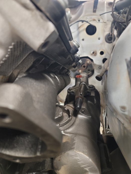

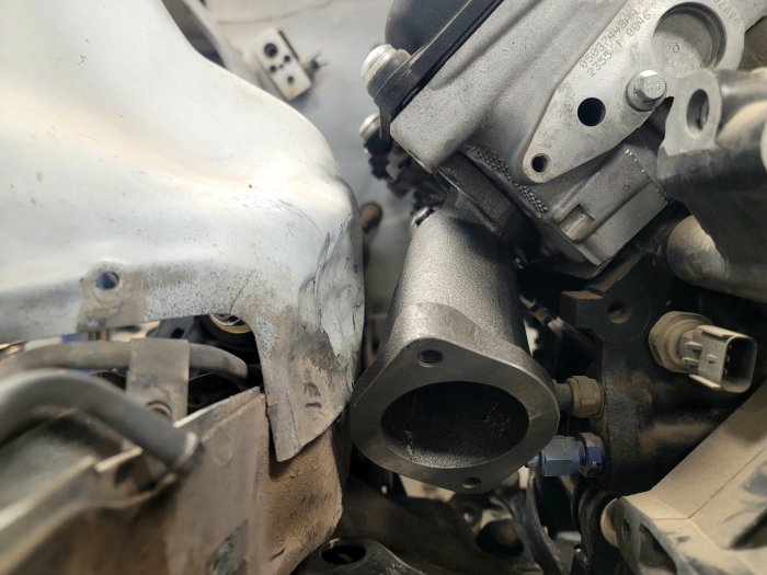

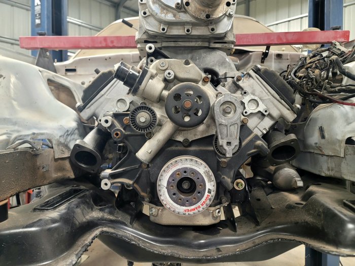

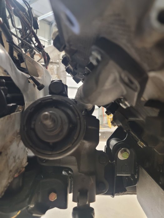

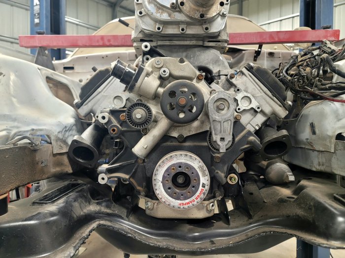

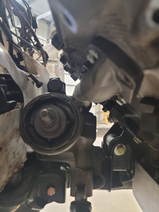

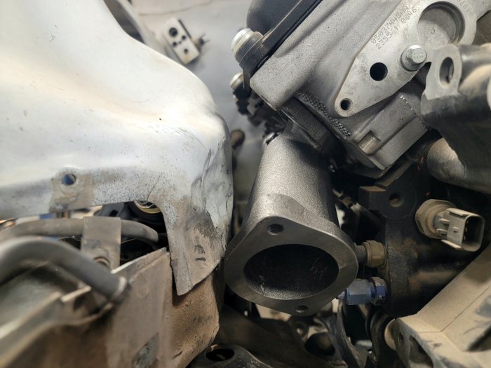

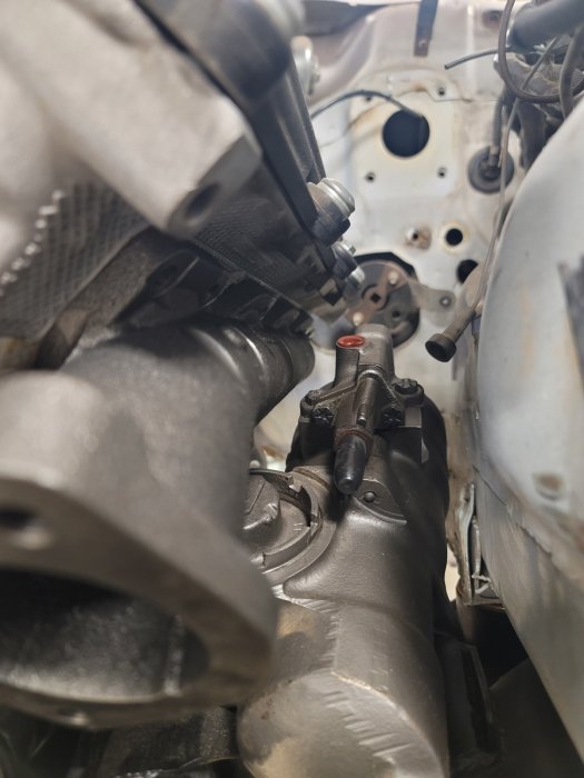

Hope this info can be helpful to some Hemi swap projects out there.
Here are some pics for reference. I'm swapping a Gen3 Hemi into an 88 Plymouth Fury. These are the Holley Hooker Blackheart low profile Hemi swap manifolds. I have them on backwards for a turbo setup, but you can plainly see the clearance they offer. I was amazed that they clear the OEM steering box.

This is one kick ass project that deserves its own thread!
