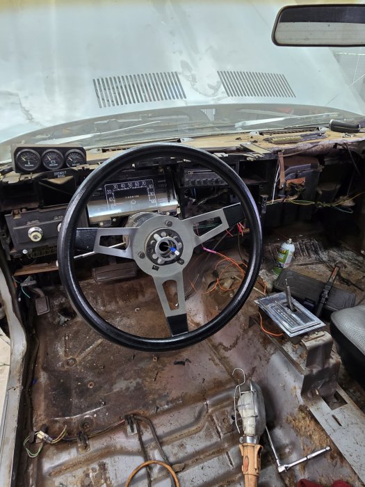

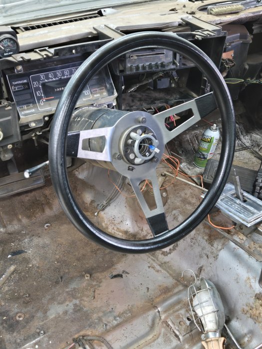

Ordered this on Amazon: Grant 846 Classic Series Nostalgia 15 inch Black Foam Grip 3-Spoke Design with Horn Button Steering Wheel.
1. It is drilled to move over the horn ring from the original Tuff wheel. In my case it lined up and mounted correctly.
2. The mounting holes from wheel to column adapter are too small. Had to drill them out slightly to get wheel to mount. (not a big deal)
3. It is NOT and exact match. It is a bright aluminum and spokes and not beveled or as thick as factory.
4. The foam where it connects to the spokes does not match factory.
5. it is functional for what I want to do and looks acceptable.

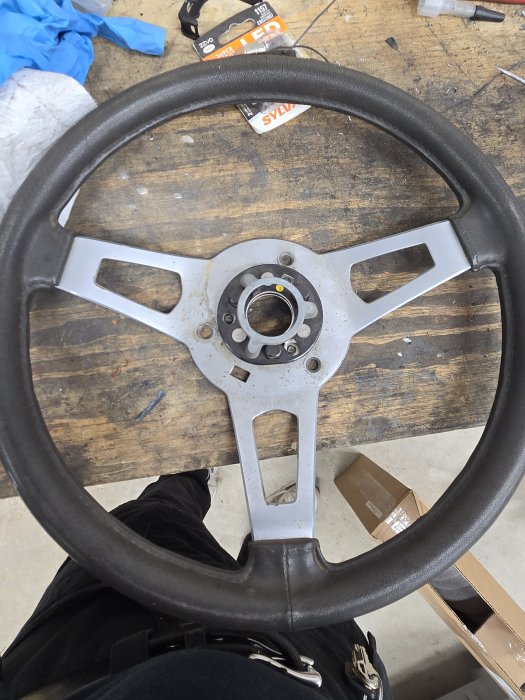

1st 2 pics are my original Tuff wheel. The 2nd are the Grant wheel mounted.
