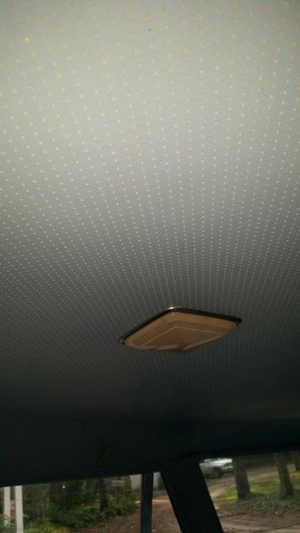

This is a picture of the headliner from my '77 Volare.
Not sure if you can see the holes in it, or not.

That is the funky stuff that was like Masonite. I had it in my 77 coupe. I wonder, was that a 77 only thing?

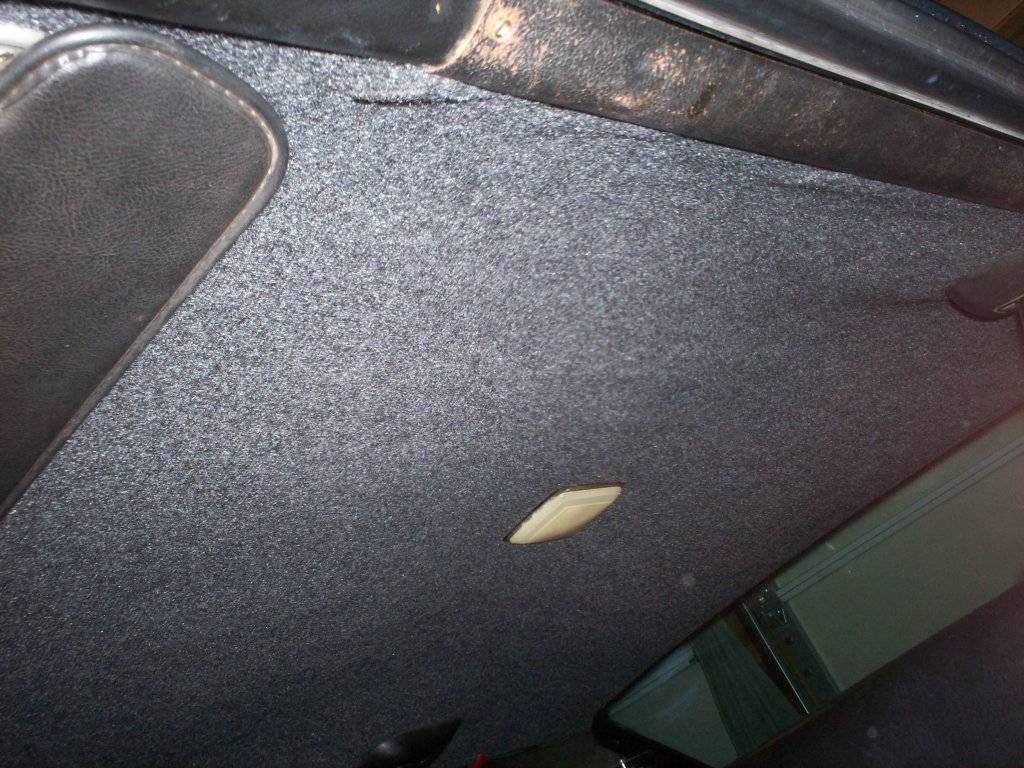

Lowes $12.99 roll of backless carpet, Gorilla Glue, Epoxy, and a 6inch rubber ball to smooth it out

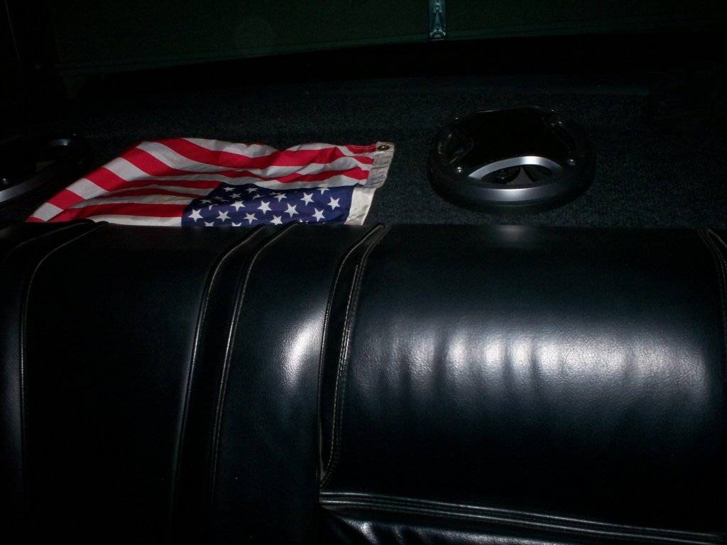

You know it wont be original but come to think about it that carpet they have that I did my rear speaker cover with worked pretty good with that lock tite. It is not to thick and not to thin might lay pretty good. Plus you can pretty much not half to worry about the molding corners it is pretty flexible carpet material. Might try it. Thank You

likewise I used leftover material on the speaker tray area too
