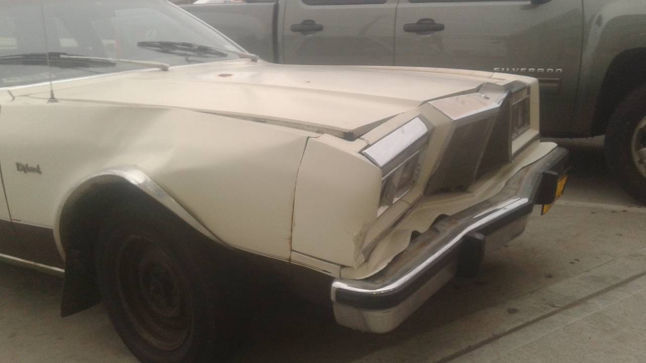

Hey everyone. I drive a 81 dodge diplomat. I was just In a accident yesterday, and need some help finding some parts. Also I wanted to know if anyone knows what header panels would bolt on to my vehicle. Here's a pic of the damage.

Must be the second time the nose got hit because that's a 80-89 Chrysler Fifth Ave nose on there.
Very possible . I don't have much history on the vehicle. There was alot if shabby work I've had to fix.

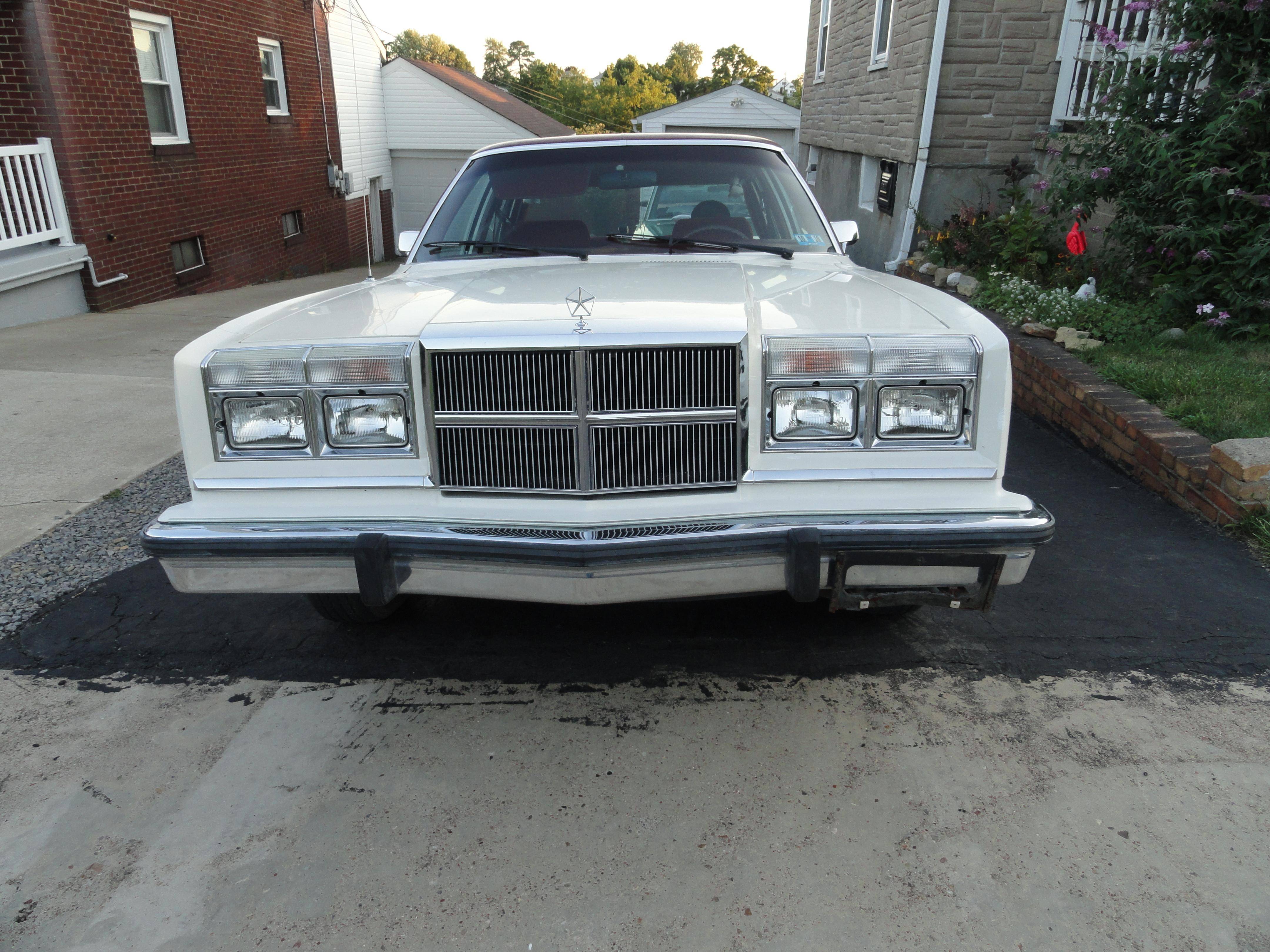

The real Diplomat nose is different than the one you have.
Yep. That's a real Dip header.
If you just want one that'll fit you've got a whole lot of choices.
Doc can correct me if I'm off but I believe
81-89 Fifth Ave
81-8(9)? Diplomat
82 and up Plymouth Gran Fury (can't remember what year they stopped)
81 and up Lebaron (also not sure what year those stopped)
That goes for fenders too.

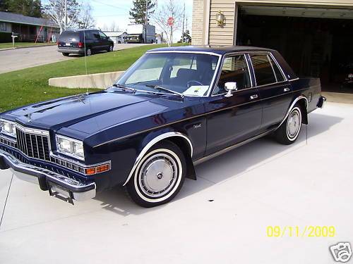

'80 and '81 LeBaron are the same and would fit, but the appearance is more like a 5A with the grille that extends over the top. Later civilian Diplomats had a different grille than the one shown. A neighbor had one with a crosshair grille on it that I believe extended atop the header as well. I don't know what year it was, though.
