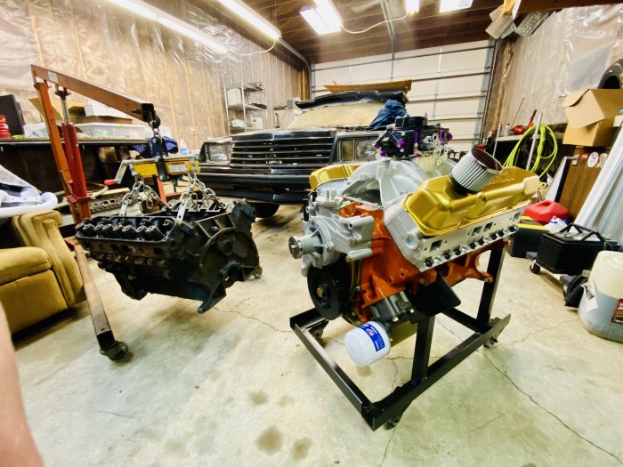

I have 440 source stealth heads on it and I have an older set of hooker super comps that I restored. I ran into a gentleman at Mopars in the park this past year with a 81 Cordoba with a 511 that he races and he has super comps on his and he said it wasn’t fun getting them in but they fit. He had to cut out the factory steering rod and go manual steering for them to work (which I was already expecting to do.) so I took the pictures that I could. Luckily at the show I found a pair for $250 and sandblasted them and painted them. Now just waiting for it to get a better in my garage so I can install them.
