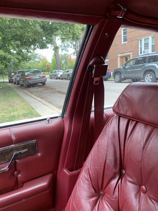

I ditched the padding on the pieces I’ve done. Comes out great. I used a vinyl that’s used for boat seats https://www.joann.com/marine-vinyl/prd23669.html
color matches the red interior perfectly. It is a task to work and stretch it into position on some of the bends at the bottom of the B pillars but it’s doable (a cloth fabric would be easier but not what I wanted).
I can’t stress your prep enough. Specifically removing the old adhesive. You won’t get anything to stick (not for long anyway) without removing it completely. I used 3M adhesive remover, works great but more expensive than other adhesive removers. I also used a 3m adhesive specifically for headliners on all the pillar pieces and such I’ve done. Maximum hold. I really didn’t and don’t want to redo those pillar pieces again if I don’t have to.
You’ll likely damage a corner of the headliner too while removing it. Almost always happens. Can use fiberglass, epoxy, duct tape or whatever you feel like doing to put it back to shape.

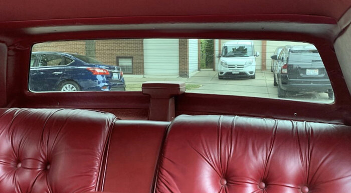

The rear window came out rough, but it’s still stuck up there solid. I used one piece of fabric...because I don’t sew. If you can sew or have someone that can help recreate the original 2-3 piece pattern, it’d come out tits.
Looks better then the torn, cigarette burnt fabric that used to be there.
