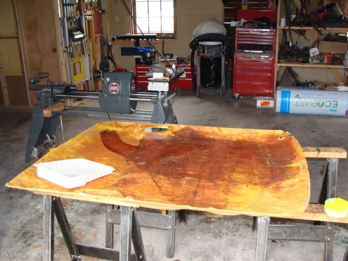

I didn't so much replace it as I did modify it. I managed to get the headliner out in one piece, removed the cloth, brushed away loose material, and soaked boat resin into it.
