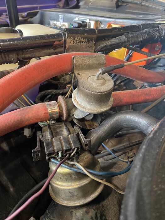

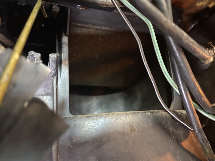

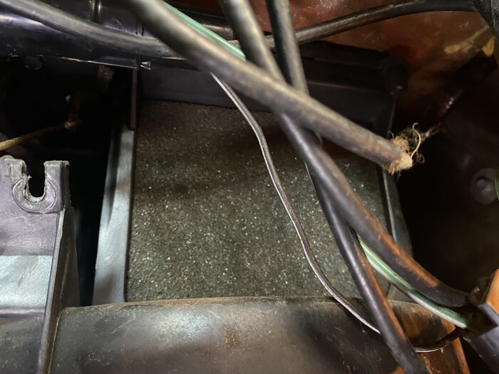

I am sending a few pics showing that I closed the valve on the heater core hose, and that I do have a clothes hanger hooked up to open and close the door. Like I say, even with the door closed, the heat comes through. Thanks for hanging in there with me on this. IMG_1042.jpgIMG_1042.jpg

Is this an AC car? Is the "heat" just worthless AC? Did you try unhooking the blower motor?

I am sending a few pics showing that I closed the valve on the heater core hose, and that I do have a clothes hanger hooked up to open and close the door. Like I say, even with the door closed, the heat comes through. Thanks for hanging in there with me on this.View attachment 50810View attachment 50810View attachment 50811View attachment 50812
I could be wrong but I think the foam padded door is for air recirculation for when the unit is in Max Cool. So if your interior is warm, that will only keep the cooler outside air from coming in if it's open to the interior. The blend door problem is over on the other side of the heater box near the center of the firewall. It's a servo motor that sits ontop of the housing. Remove the motor and ponder how it moves the blend door then start designing a manual rod. It's accessible thru the glove box once the box is removed, removing the passenger side lower cover below the glove box may make it easier to take out too.

Yeah, I will need the heat soon, but still hitting around 80 the next few days. I actually tried connecting a coat hanger to the door after I disconnected the actuator behind the glove box, closed the door with it, and locked it in place, and it still let the hot air in. If it worked, I was going to connect the aspen cable. It wouldn't matter to me if it was manual or not, but it didn't stop the neat. Not sure what I am doin g wrong with it. Thanks for staying connected with me on this. I'm open to suggestions.

I just saw your previous post, and yeah, maybe that wasn't the blend door I connected to. So the servo is inside the car, and I should be able to see it on the left after I remove the glove box?
yep, it's tucked down in there but it looks like it was just barely designed to be accessed down in there. Check the electrical connector first, they can get loose I have heard
