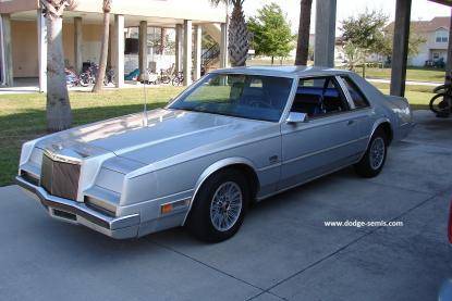

Long time Mopar owner but a couple of years ago I bought my an FMJ car. So I thought it was about time I joined the forum here as I have some ideas for a few mods and have many questions. First off let me introduce the car that started my trip here. It's a 1981 Imperial.
http://www.dodge-semis.com/1981Imperial/
She received a first place trophy in the very first show I entered her in to. I have some pics of that show at http://www.dodge-semis.com/CS/TV2012/. I've entered it in to a few other shows since then but no luck. Had a lot of fun though. She hasn't been running right so I parked her for the better part of the last year but now I have some money coming that I can spend on her to fix that problem. Also want to rebuild the front suspension as there's something worn out in the steering system.
