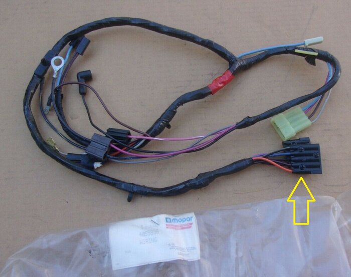

this is for 78 but I wonder what is the difference? Also it looks like only a portion of the harness
NOS Mopar 1978 Aspen Volara Lebaron Diplomat 318 360 Engine Wiring Harness | eBay
That is the engine side harness - with Lean Burn (air cleaner mounted computer system).
The yellow arrow points to the major clue.

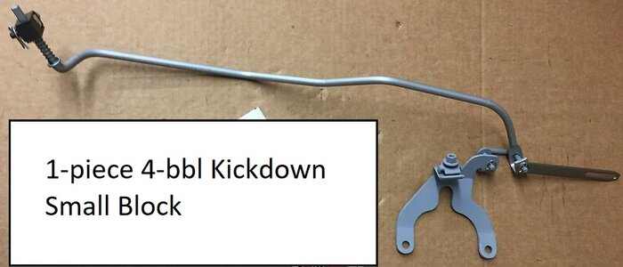

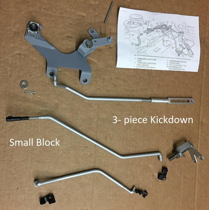

The problem with finding kickdown linkage is finding a complete (and correct) assembly. They can be found but are expensive. I have seen several people sold a kit that used incorrect parts – which ends up being useless. Most FMJ bodies need a 3-piece linkage system that looks like:
The 1-piece linkage setup hits the firewall so not recommended – if looking for physical linkage setup.
I highly recommend getting a Lokar (or similar) cable kit. If using a stock air cleaner – the cable setup is not highly visible. It is easy to adjust and not too hard to install.
