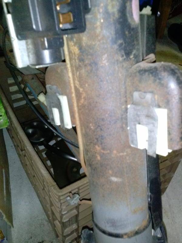

The two bolts that support the column to the dash need the metal clips for grounding. The horn relay, located on the fuse block, should have an audible click as you press the horn button.

Thank you. Column has never been messed-with so of course when I got the cover plate off I saw that the bolts/clips were where they should be. So, easy thing first. Swap in a new relay...... fixed.
I had torn into my parts car dash and couldn't remember any ground clips, but now that I see what was meant.... yea, I remember.
Thanks, again for taking the time to post a pic. Brad
