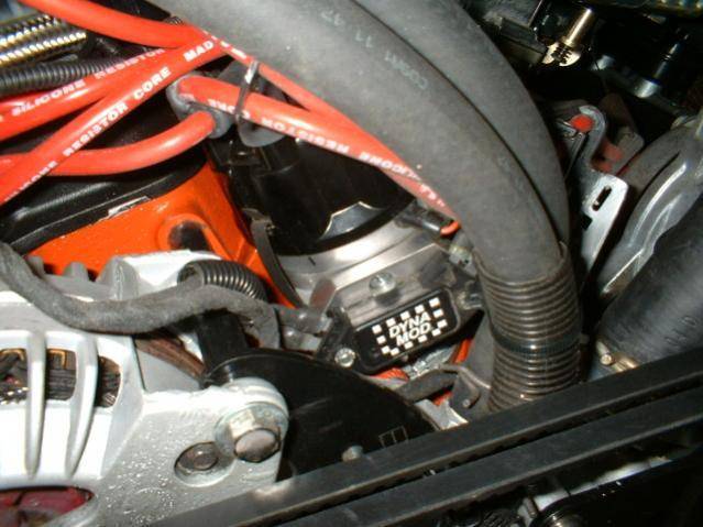

How do you all feel about this adjustable advance HEI distributor?
8v-of-fury
May 7, 2014
435
40
Orillia, Ontario
It claims to be a 2-wire hook-up, where you give it 12v and run an external coil of your choice.. I assume a high powered one?
They also claim it has an easily adjustable mechanical advance.. which is pretty damn cool to me. (pardon my ignorance if this is not desirable, i am pretty new to distributor/carb engines.. mostly diesel knowledge)
The distributor in question.

The electronic conversion kit I am using. << As it would appear looking back at the info for this dizzy, I bought high-performance one! LOL 7500rpm and a WILD advance curve!
The reason I am asking for your opinion on the adjustable distributor is because the proform one comes on pretty hot, and for a stock 318smogger with stock everything but the ignition and an addition of a 4 barrel.. It is fairly hard to get tuned properly. The adjustable mechanical advance seems like it would be worth the price to me.
How do you all feel?

Did some reading, even the Mallory race ready distributors come with a preset 20* of mechanical advance.. Could the one I have possibly be more?! I guess i need to get back in there with a light and subtract my initial timing to see eh?
Again, sorry.. carbs and distributor tuning is all new-ish to me. Been around them, but no tuning experience.

Soooo would my ProForm distributor, which seems to be a mopar knockoff, that I purchased in 2014 have the adjustable advance? I guess I'll have to pop it apart and see eh:
