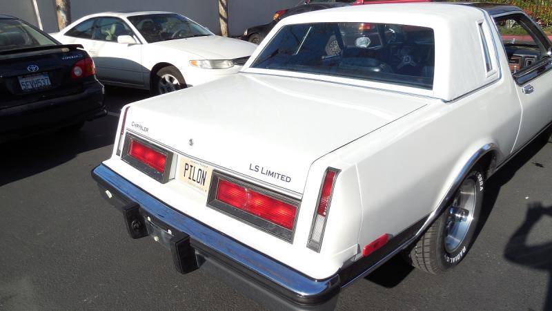

You should see the way they get all twisted up in the heat here in Phoenix, especially if they are off the car.
I have "corrected" the warp with heat...reshape gently...hold and cool. May have to try it on my wagons rear filler this winter. Its getting curly on the ends.

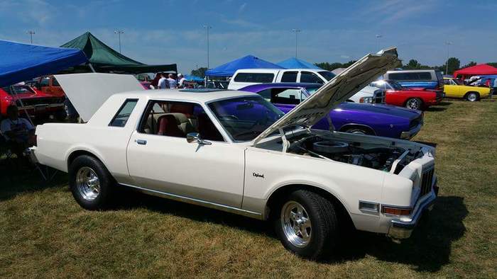

Trim it and move the bumper in. Saw it on an M coupe at mopar nationals..didn't realize it till he pointed it out.
brotherGood
Mar 31, 2013
895
162
Urbana OH
I don't think there's enough left to warp. He did that because it had warped really bad.
